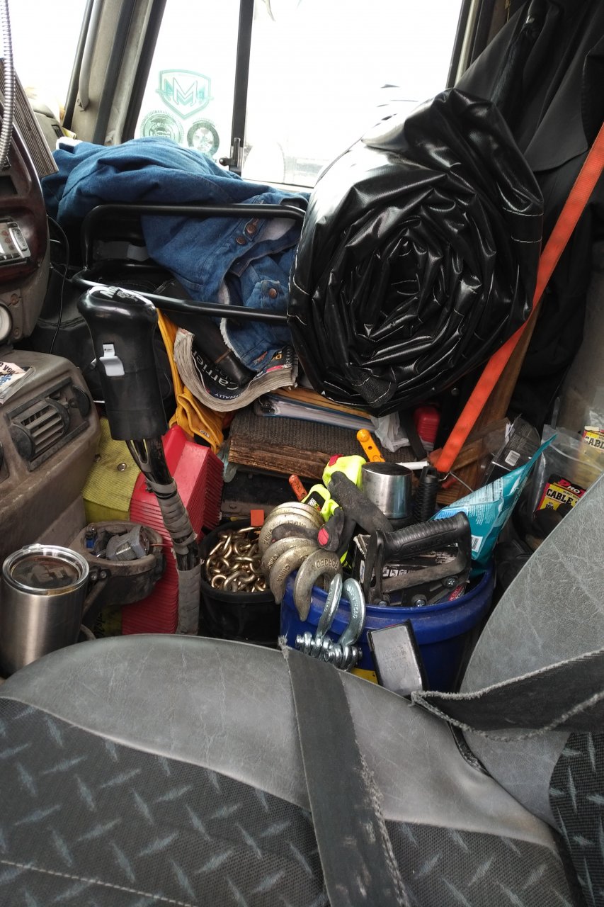

    I've been through several inspections, and nobody has ever said anything... IMG_20171107_1126141.jpg
    If there is a regulation stating as much, I've never seen it, and it's never been enforced against me. The only regulation that I know of that mentions having something any equipment inside of the cab "secured" is the fire extinguisher, which must be readily accessible and securely mounted. It's also wise to keep things contained so that they don't end up on or under your pedals...but that's just common sense.
