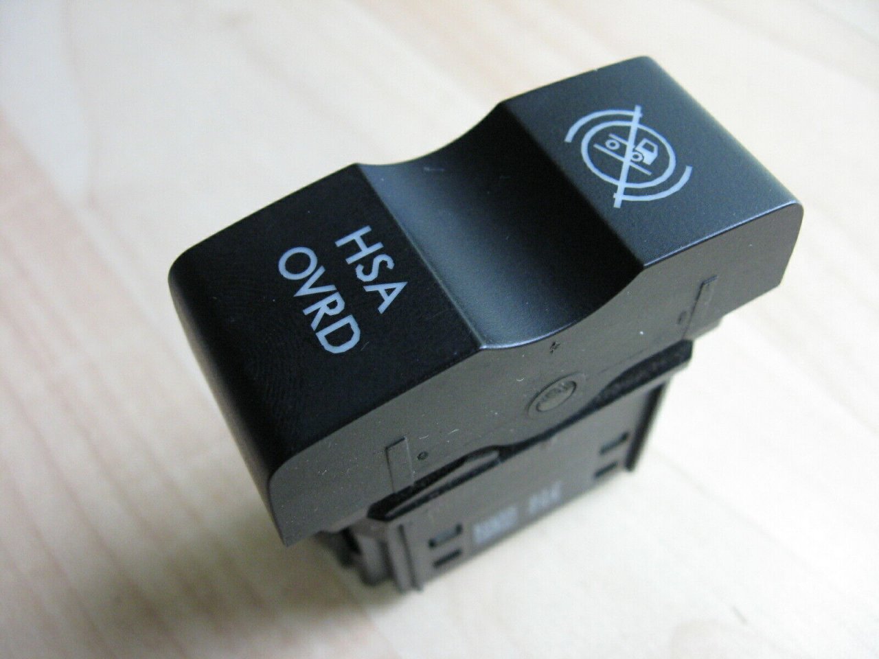

    Turn off Hill Assist.
    Button with truck going up hill with circle around it.
    It’ll come back on automatically.
    Since Western Express i’ll assume freightliner

    If your tractor is an automatic and has Hill Start Assist, turn it off while backing. Also, turn off your jake except when you are on the road going forward. There is no need to be a load clueless jerk but many drivers seem to find a way.
