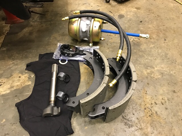

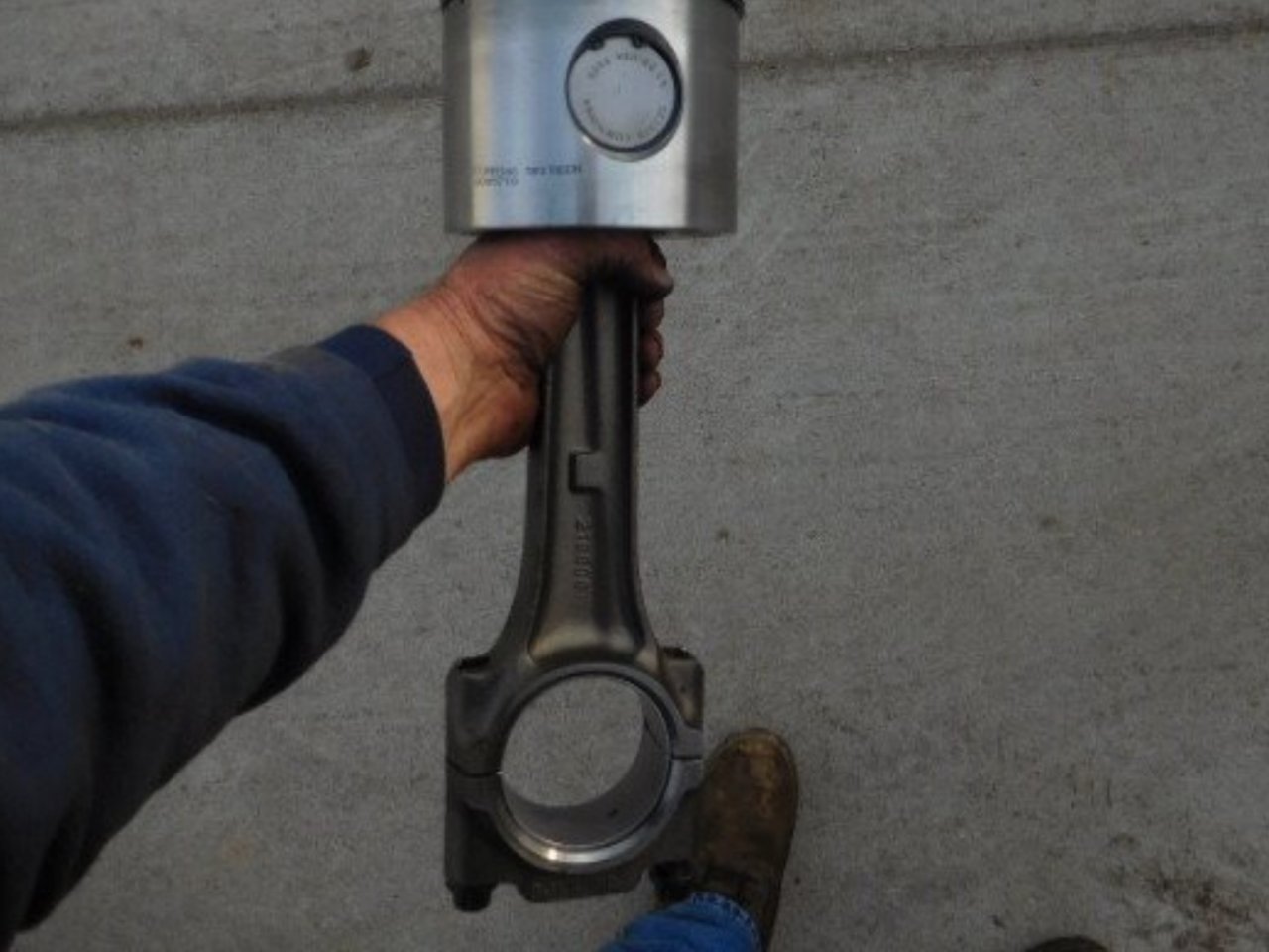

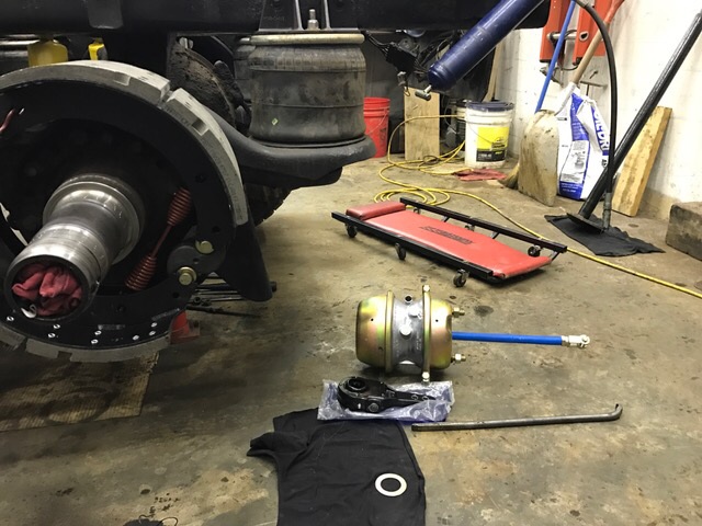

    No body can tell you more about the engine than the people who designed it for the most part, but a good honest mechanic will give you some insight, at least better than some guy on a radio that never pulled a wrench on it. I'm sure Kevin has good intentions.... maybe not for you the listener exactly, but definitely for himself. As @mtoo said use your eyes, use your ears. I started out replacing a couple air bags, and the wheel seals. I seen potential problems with other things and ended up installing all new air bags, new brakes, S-cams / bushings, brake chambers, wheel seals, shocks, and today will be installing new pinion seals on the rear drives with new Ujoints on the jackshaft between the punkins while I'm there. I was told the spare engine had just had a in-frame before pulling it out, but there was no paperwork proving that so what did I do? I pulled it apart and looked! I want to know personally! Pistons still had the part number on the skirts, bottom rod bearings and top main bearings did not have a mark on them, liners had a perfect cross hatch, all good signs the man was honest. Kevin gives good advice on at least one thing.... Do the hard work, in my opinion that is getting your hands dirty, as well as doing the numbers. Be safe out there.
