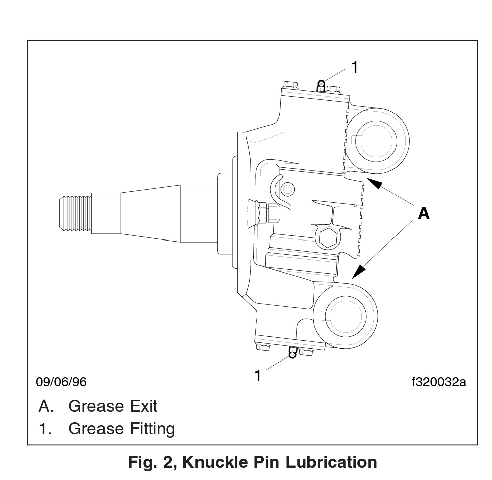

    So here are the documents from the Freightliner Cascadia Maintenance Manual from 2017 and the 2007 version. Both say not to raise the front axle to grease the king pins.
    I think it’s possible that some king pins require to be raised when greasing, so you would want to look for the documents showing the proper greasing procedures for your king pins.
