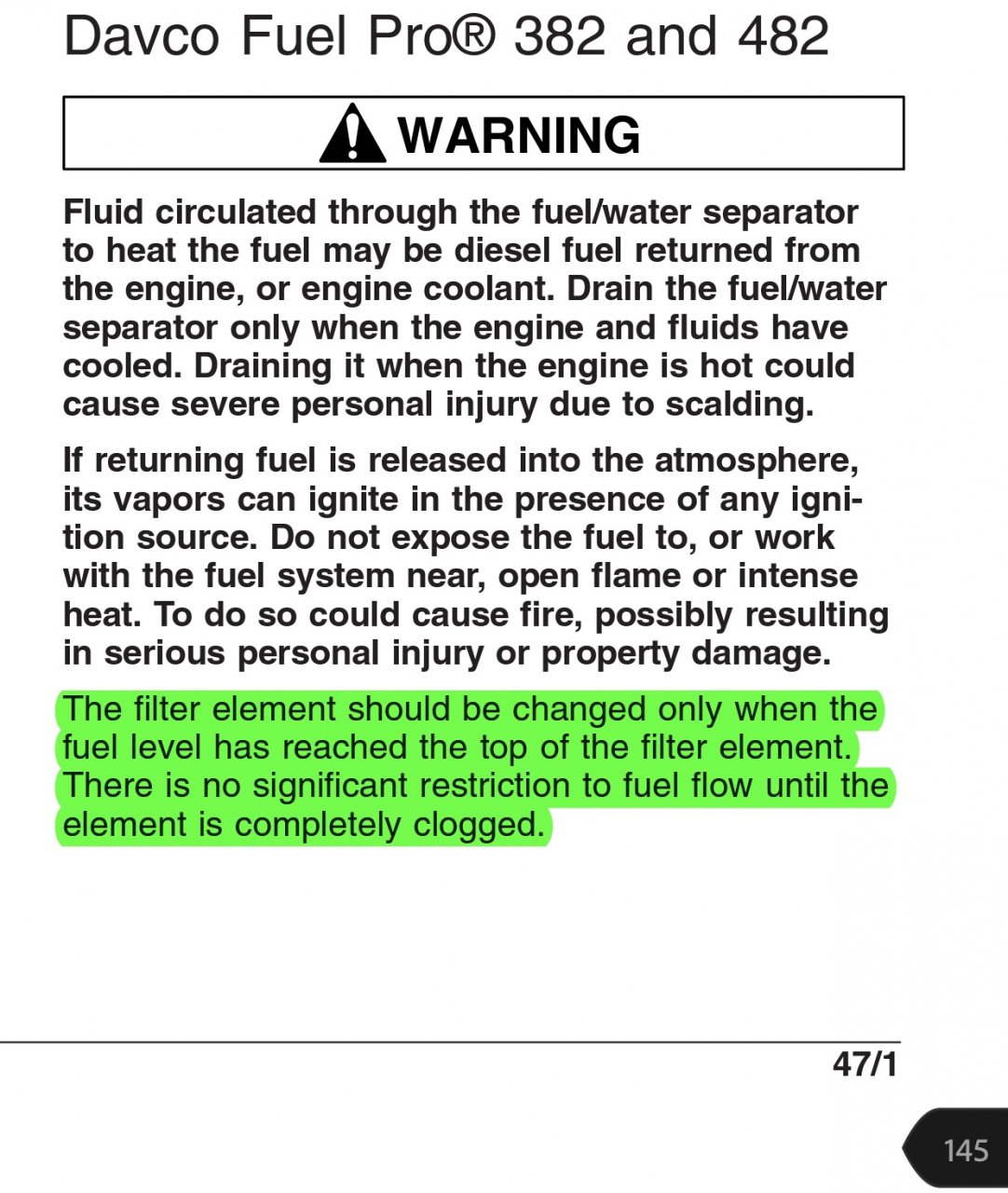

    I do my oil change and fuel filter change based on my engine manual for long haul. I haven’t had any problems. I also do not idle. I recently learned that my fuel/water separator can go much longer or until it hits the line “change filter” on the transparent case. My maintenance manual says it’s okay, and it also does not list a mileage or interval for the fuel/water separator, only for the filters on the fuel filter module.
