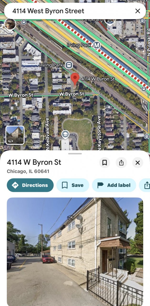

    That looks oddly familiar. I swear I've seen that house before in pretty much this same circumstance.
