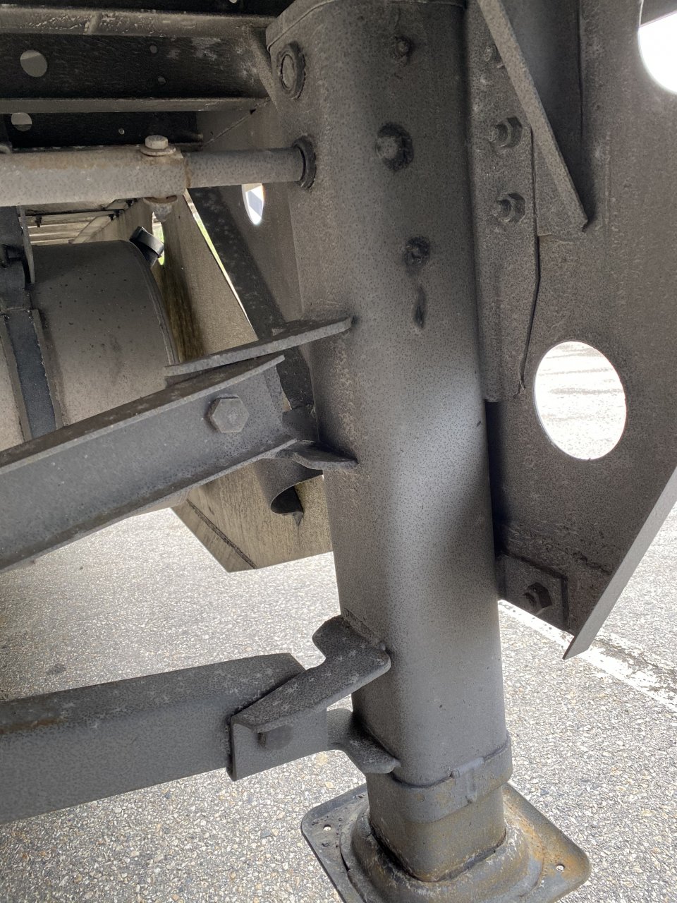

    Anytime I park an air ride trailer I pull the trailer brakes and let ALL the air bleed out, it'll push the tractor forward a good 6-7 inches. Once it's all bled I pull the parking break and unhook. Yard dogs do not do that, at least I've never seen them do it anywhere I've been. I do think though that the flattening of the arch is what's causing your landing gears to bend. I'd definitely keep them hooked to a truck while loading and see what the difference is

    OP, What are you loading and are your trailers being end loaded at a regular dock?

    All in all, what I would personally do first is replace the landing gear foot to a rolling type.
    I’ve been also thinking that the problem could also be the quality of the landing gear. No offense. If this is a problem for all flat beds in that shipper, then the shipper could be doing something wrong. Something tells me, however, that this is not the case.

    I don't particularly care for the rolling foot landing gear. Easier to sink in a soft spot.
    As far as the OP's landing gear......looks a little on the cheesy side, light weight type. I prefer Holland Mark V and similar. Plus I would stay away from the round adjustable tube supports. Nothing like good sturdy angle iron supports!
    I would be willing to bet that where the trailer is being dropped for loading there is a hole where the landing gear is resting allowing no sliding whatsoever.
    I have quite a bit of experience with dropped aluminum flats as both a driver and a yard jockey. Something weird is going on here! If the trailer is being side loaded it would be nice if shippers would load from back to front giving the gear a chance to slide forward a bit without damage. Sadly this almost never happens! If they are driving on the trailer end loading it empty without a truck underneath then they are flat crazy!

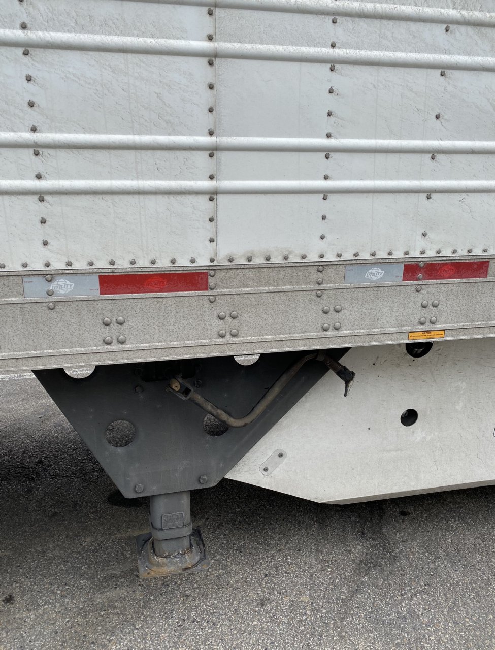

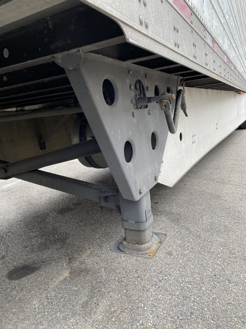

    This is how the landing gear on my reefer trailer looks like, but box trailers don’t have an arched floor. It’s a Jost International.
  9. PE_T
    PE_T Road Train Member
    You mean the landing gears bending? Not on the reefer side.

  11. ChaoSS
    ChaoSS Road Train Member
    3,338
    6,758
    Sep 20, 2014
    No I mean loading trailers from the rear, starting at the front, without being supported by a truck.
