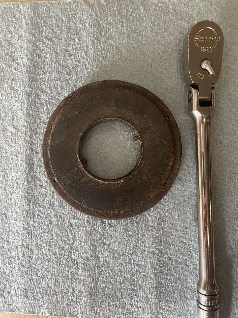

    First being NEVER touch the throttle to get a truck moving. You shall NEVER have a foot on the clutch and one on the throttle at ANY time. One or the other. You will significantly lower the lifespan of the clutch by using the throttle to take off (not to mention put a ton of unneeded stress on the driveline).
    Clutch pedal only goes to the floor when the truck is stopped. This engages the clutch brake, which stops all the gears in the transmission so you can get it into 1st or reverse. Once in motion, you only ever touch the clutch enough to break torque and only for about a second.

    5F7E3DD1-50DF-4841-B5F8-DE682D77E424.jpeg For those who have never seen a clutch brake….
