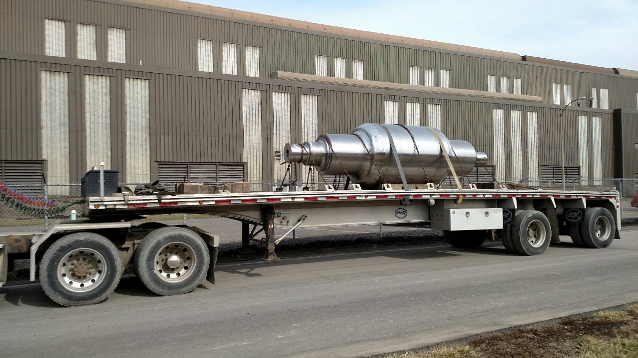

    You can put a lot of weight on an aluminum trailer if it's speced right.
    I've loaded mill rolls that weigh over 86,000. That's just the roll weight!
