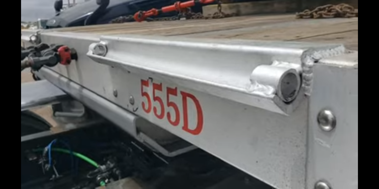

  8. D.Tibbitt
    22,866
    158,125
    Make sure ur step is built to have ramps because not all of them are... Theres a round "channel" (for lack of a better term) where the ramp end would sit flush into the trailer and then a pin is inserted to keep it from falling and moving..
    I have witnessed the attempts of drivers using ramps on stepdecks that arent set up for it and its not pretty... Although i cant say it cant be done.. Its just dangerous and sketchy, and I certainly wont be in the drivers seat of the equipment being loaded, and make sure whoever is , signs a waiver saying all damage is on them from that point forward. and then grab the popcorn and enjoy some free entertainment :biggrin_25523:
    Heres a pic. The ramp end falls flush into there and then a pin is put thru the hold the ramp in place

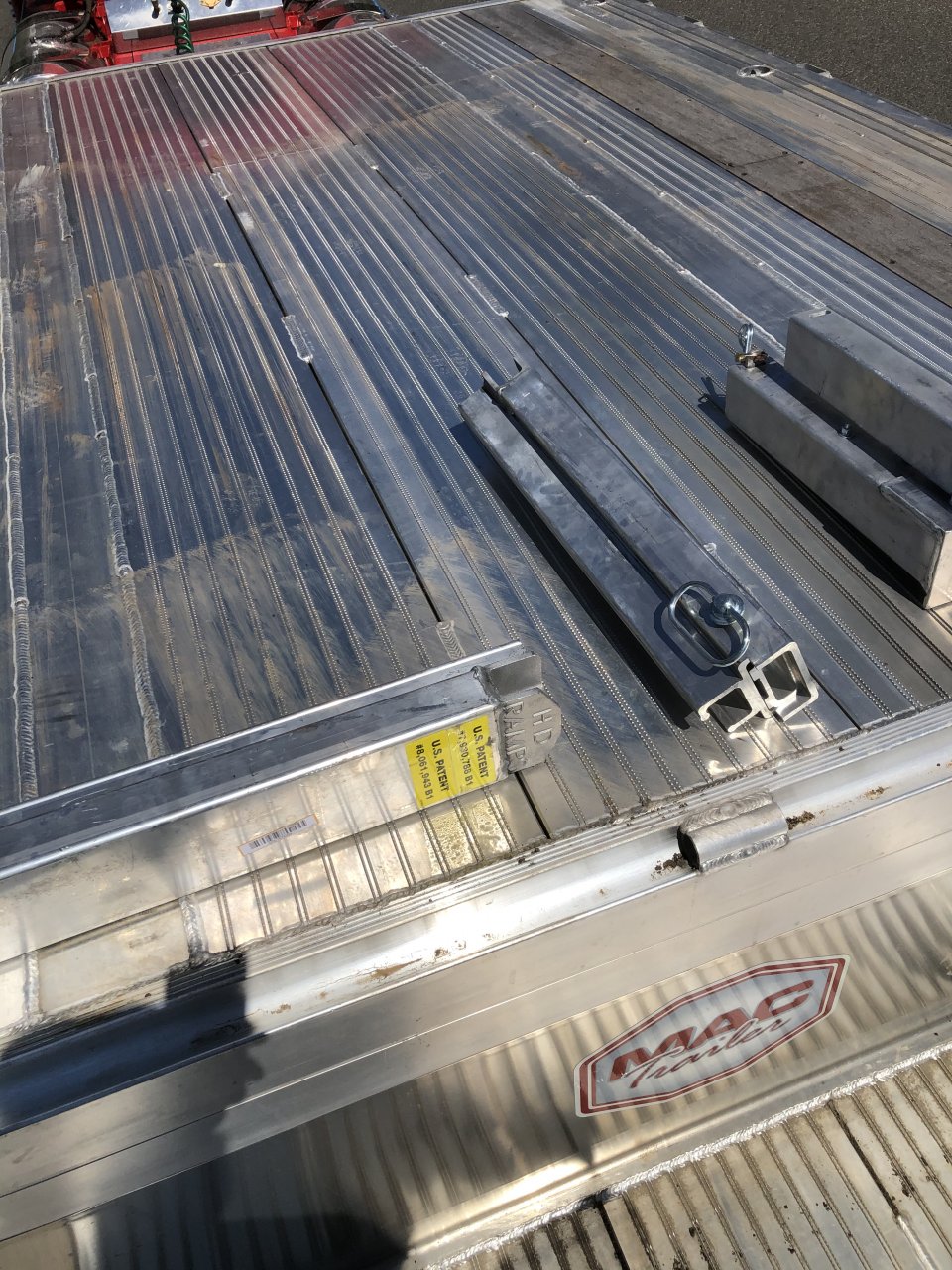

  10. Ruthless
    Ruthless Road Train Member
    9,263
    92,267
    Aug 28, 2010
    The City.
    betcha $20 they aint for ramps.
    all new mac stepdecks come with the saddles from the factory anymore.
    let me see if I have a pic you can see them in.
    @D.Tibbitt
    Idk man the way them ones are hanging off the nose like that from the top deck.... sure the machine wouldnt won’t rip those saddles off and crash riding down with the huge set of balls the operator would have to have?
