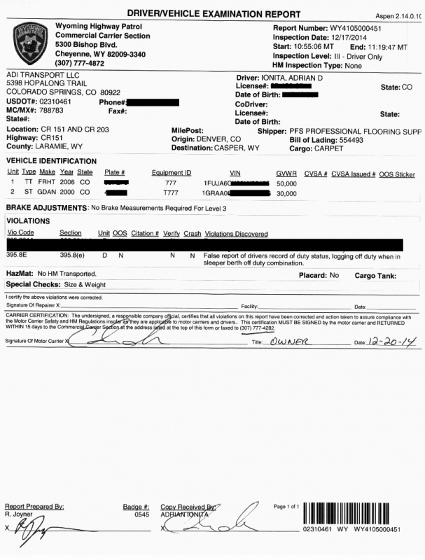

    Here is an original post from 2014 by a driver who was busted for not logging any time in the sleeper even though he used the sleeper. Included is an attachment showing this inspection report which put CSA points onto his motor carrier authority.
    Below is the inspection report CSA violation this driver was written up on. You can clearly see the driver was written up for 395.8(e) for falsely logging off duty when they were using off duty and sleeper in combination for their break.

    You and I as lowly truck drivers know this by using common sense but the regulations state that we must log "true, correct, and current" all of our daily activities on the Record of Duty.
