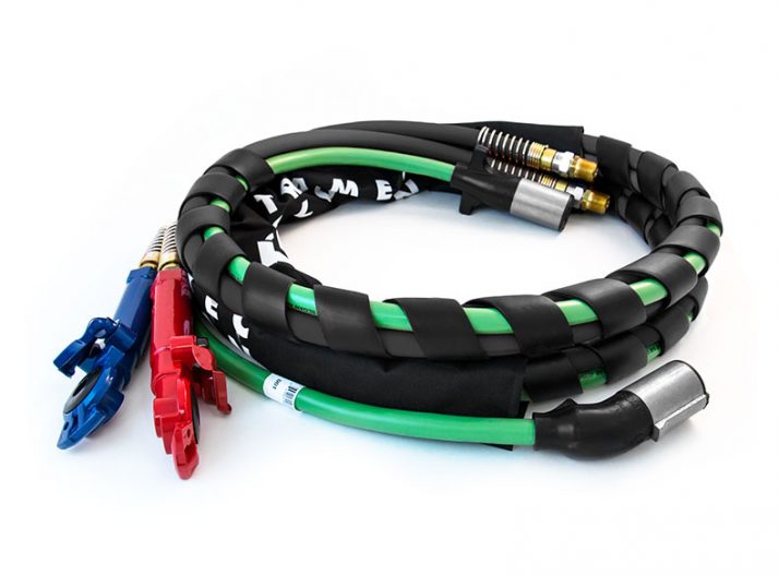

    6B670911-4ADB-4692-BFA3-4B2E66C8D1FF.jpeg www.techtran.com
    You can get ones like this. They work well if always pulling same trailer. We have a variety of trailers and they always need adjusting as to not be too short/long.
    1johnb, Lepton1, Cat sdp and 3 others Thank this.

    These are rubber hoses?
  11. JoeyJunk
    JoeyJunk Road Train Member
    8,762
    68,032
    Dec 31, 2010
    Washington, PA
    Yes
