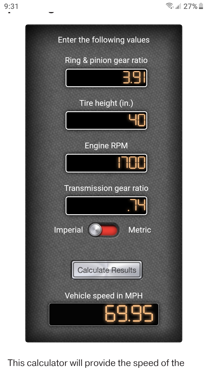

    Something ain't lining up with the specs you've given. Even put you on low pro 22.5 as a tire size. Could be on tall 24.5's for that matter..

    Got the link to that calculator by chance

    I’ll have to edit my original post I got 11r 22.5 all the way around. I guess I need to crawl under there and re-verify the the model number. I know some 8lls have a 1.00 final drive, the one on my build sheet has the .74 tho.

    Spicer Transmission Ratio RPM Calculator
    Hopefully that works.?
    I just put Spicer gear calculator into the search bar if the link is no good.. :thumbup:

    Truck's what, probably 25-30 years old? Build sheet isn't reliable at this point. Who knows what's been done to it over the years.
