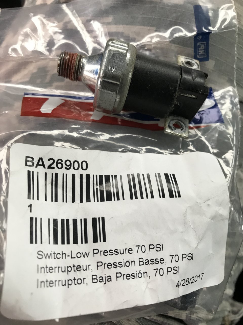

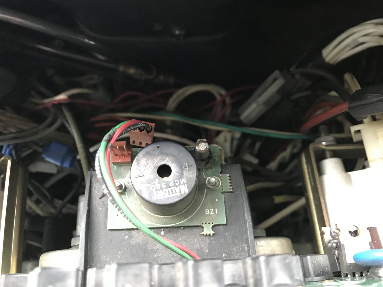

    So - the air pressure is fine, but the buzzer stays on. If you can't stand the racket, take the dash panel off ( key off, and careful not to sparky spark - or disconnect batteries) , and pull the orange 3-wire plug.

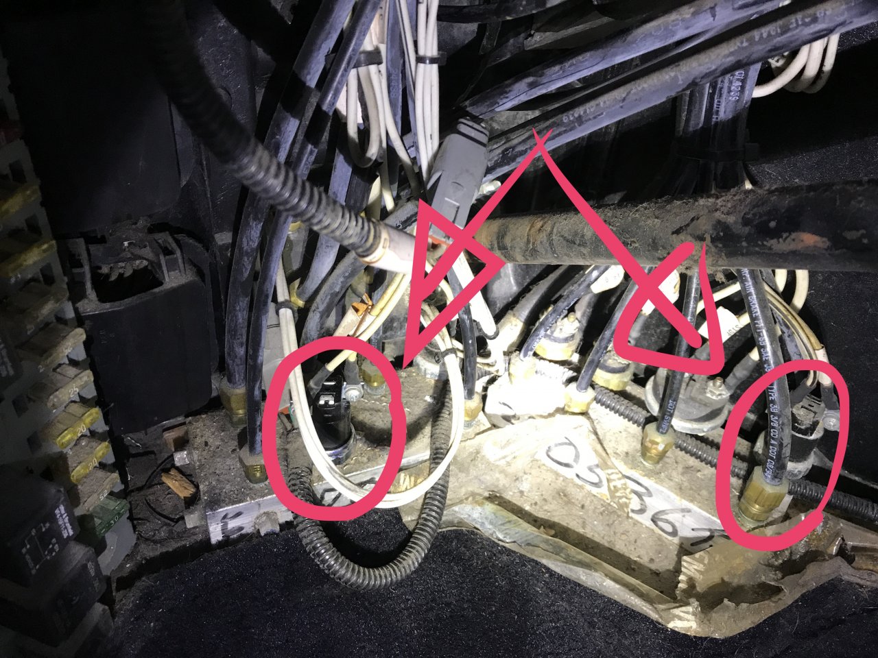

    Low pressure switches are on the floor, behind the pedals. Two covers, about 10 screws. DRAIN YOUR AIR TANKS. Adjustable wrench or channel locks to remove the switch, 2 screws hold the two wires. Clean off area with toothbrush and rag to prevent any crud falling in manifold.
    I didn't see the one on the right at first - but guessed lucky. So I went back in to Peterbilt and bought the other one for a spare.($14).
    Replaced the buzzer plug, aired up and tested.
    Charged myself $289.75, and a case of brake cleaner.
    Hope this helps - Google led me back to TTR, but I didn't find my problem specifically.
