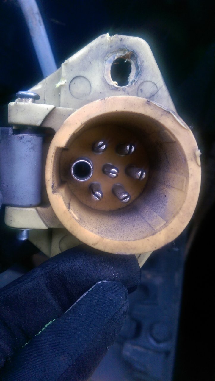

    So I need to add a pig tail to my truck right? For dump switch

    Yes. But if that trailer is one of the great Danes. It does not have a normal plug. The cheap smart way is to change the plug to a normal one.
    And don't put another green pig tail on your truck. You can use the older black ones, they are cheaper, and makes it easy to remember which one is for the lights/abs, and which is just for the dump valve

    I have a spare power cord from when I switched to heavy duty airlines. So when I hook up the pig tail there will only be 1 wire right? I'm have extra time in little rock this weekend into I can deliver at FedEx lol.

    sarasota, fl
    2 wires. A hot, and a ground.
    Get the ground off your frame rail somewhere. And the hot wire will be to be routed from a toggle in the dash. If your truck has extra sparerifles it's just a matter of finding the wire along the frame. Will usually be plugged off with the writing harness running asking the frame rail, about the end of the sleeper. If you don't have spare rifles from the factory, you will need to run one from the fuse box to a new toggle you install, and then from there to the back. This means drilling a hole in either your floor or fire wall. Make sure you put a rubber grommet in the drilled hole so the wire dies not rub though. And I would also fish the wire through quarter inch air line for additional protection. Then just zip tie it to the factory harness back along the frame rail to where you are going to install the plug for the pig tail. nothing expensive about this, just rather time consuming. It's a good Saturday project while at home. Something to keep in mind, if having to run wire and plumb everything to a 7 way. Might as well run some extra wires so you can later add more things. Back up lights and beacons on the end of the trailer for example.

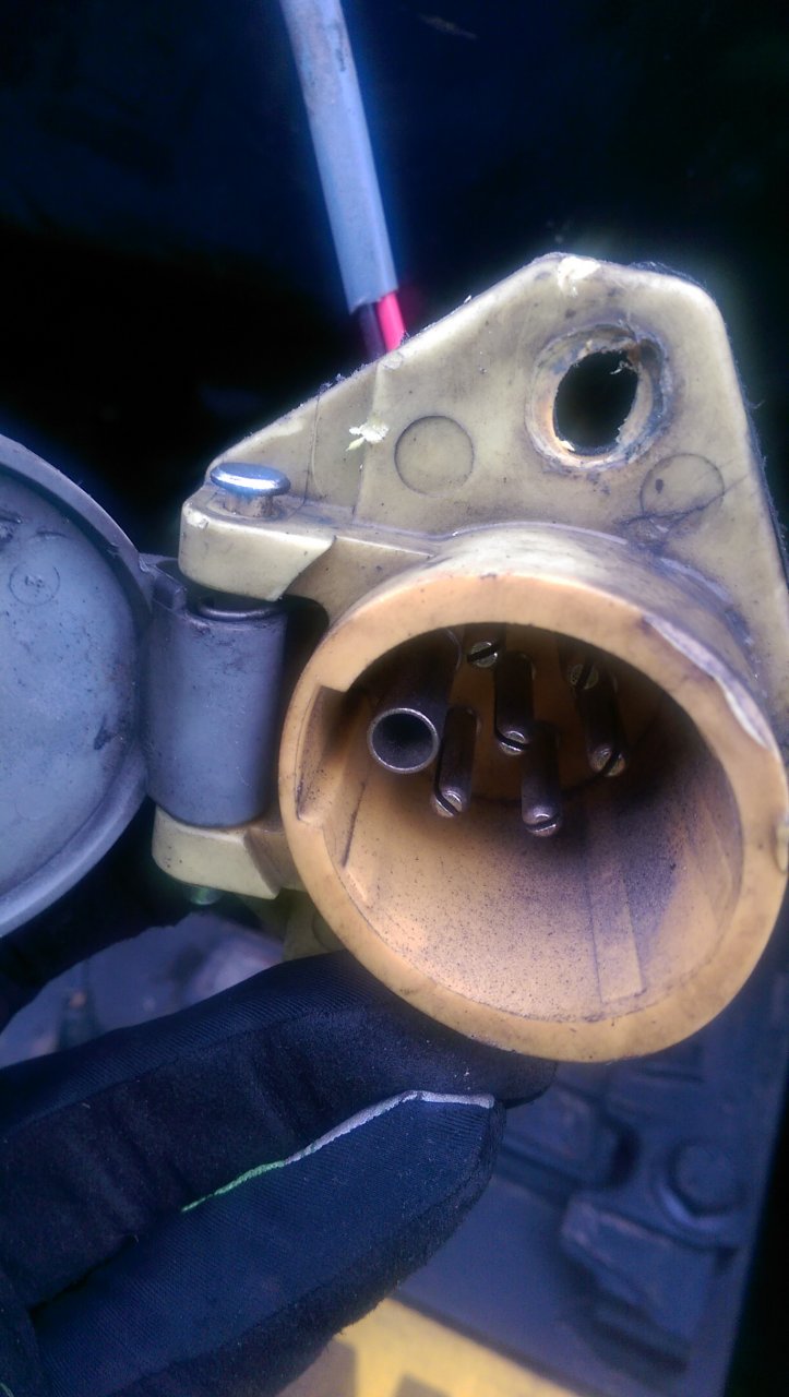

    This is what's there now maybe I should wait into I get home? I know auto stores sell a circuit u plug into your fuse box and has hot wire coming from it.
