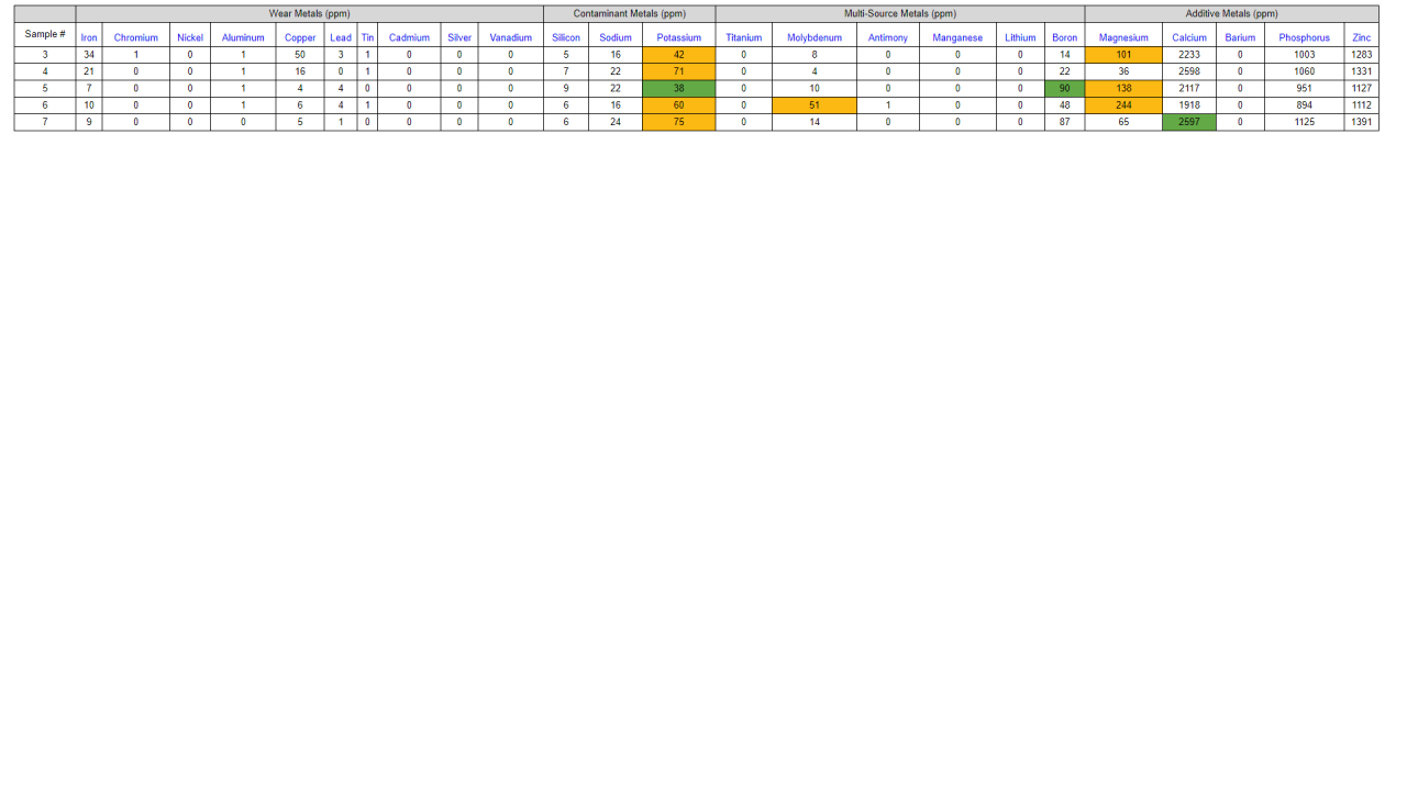

    That's kind of a slow leak so maybe you're catching it in time before it gets bad. What year is that truck?

    its an 07 just rolled over to 810k miles. Its been leaking for a bit.. I thought last time i found the leak but i didn't. I think its getting Burned in the engine somewhere.
    My Sodium is little high but not flagged like my Potassium so its for sure coolant. oil.png

    Have you deleted the egr? If not I'd check the egr cooler. They are notorious for leaking. Also, you might get on rawze.com & ask around. There's a few guys on there that know those cummins engines better than 98% of the techs you'll find.

    Egr is welded. Good news clutch is fine lol. He can't find anything wrong. Maybe it's just the new seat throwing me off?
