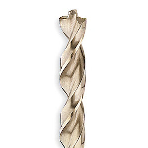

    I use bits that look like this. DeWalt makes them, just make sure on the package that is shows a picture of a steel I beam. Keep the speed down and they will make a lot of holes before going dull.
  5. spyder7723
    spyder7723 Road Train Member
    15,471
    25,076
    Mar 31, 2013
    sarasota, fl
    That's the key to drilling hard materials like steel. Use oil to keep the bit cool and keep the speed down. Slow and steady.
