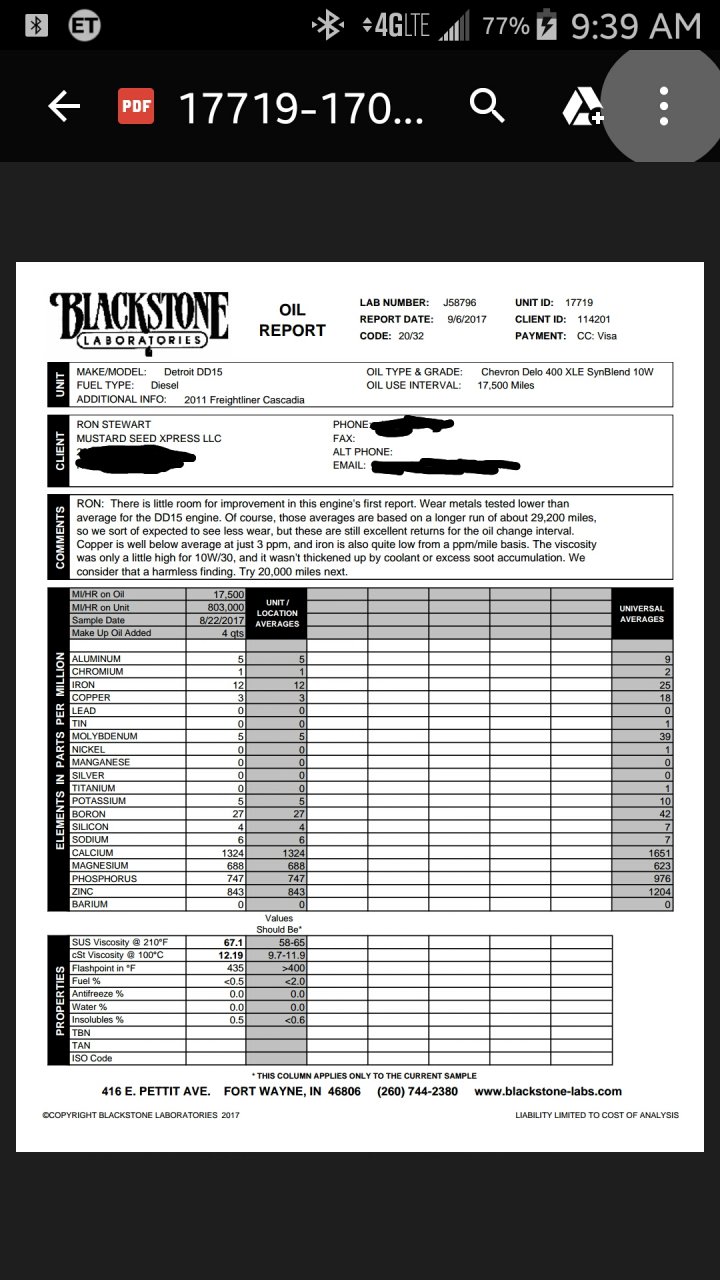

Got my first oil analysis back. I'm pretty impressed with what it says about my engine. I changed the oil early on this one cause I thought I might be having issues. According to this sample all is good. I'll be sampling every 10k miles from here out.

i would sample at 20k To be honest.. Your sample is very cleanRStewart Thanks this.
Then I may do my original plan & sample at 15k & service at 30k. I was surprised it was this clean with as much idling as I do.
just got my sample back today. wish it was as good lolRStewart Thanks this.
Lol. I just hope mine stay good. I'm not ready for an inframe yet.

That sample looks great. I would also stretch out the samples from 15k, unless, you think there's a problem. If you are going to change oil every 30k, I would just sample at 30k.
Do you run an oil bypass filter? If not, its a good investment.Airborne Thanks this.
