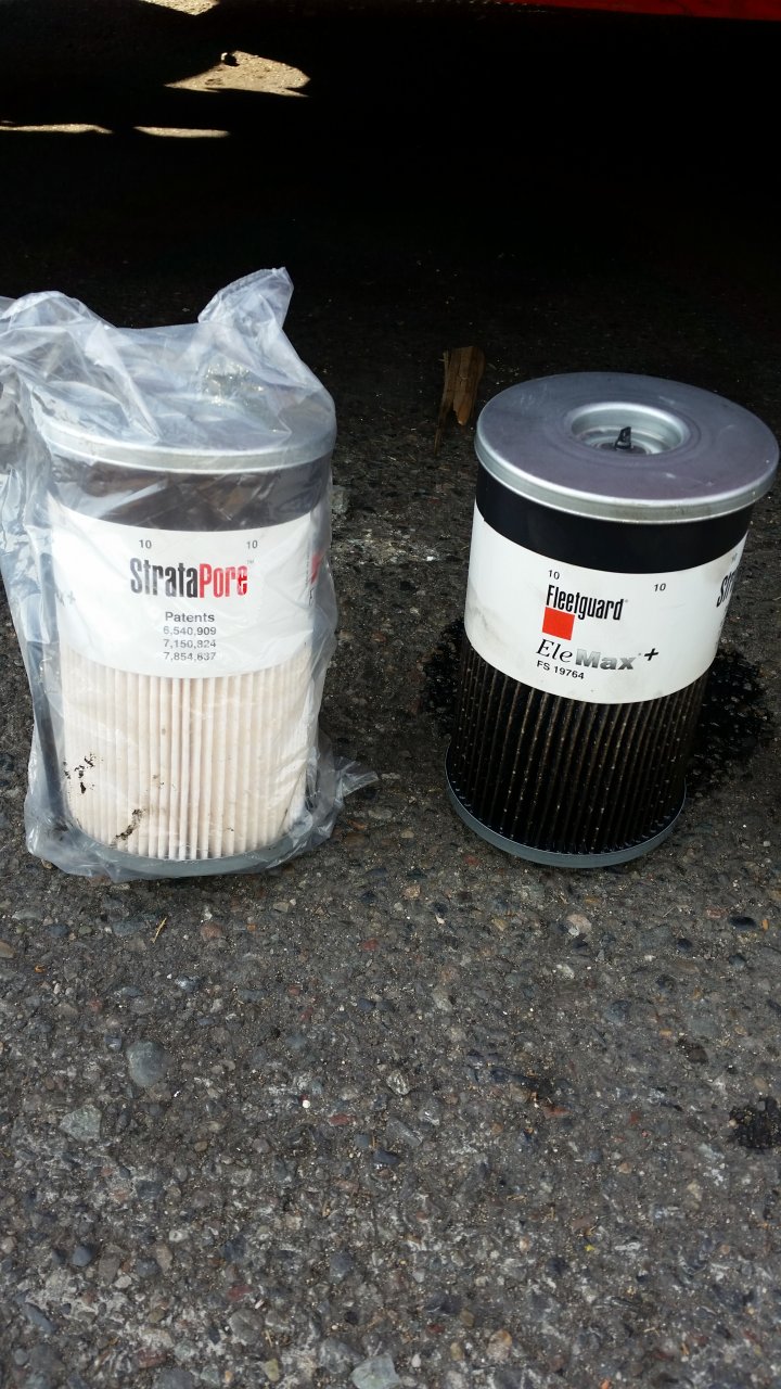

    This filter has 10k miles on it.... I've heaRd everything from algae, injector Orings, engine needs over hauled, to bad fuel... I called Cummins and first thing he said was Injector Oring... so I want to take it in. Also want my fuel pump worked on... 20170916_121857.jpg
  6. Oscar the KW
    Oscar the KW Going Tarpless
    12,247
    28,120
    May 19, 2011
    How do the insides of your tanks look?

    Oct 2, 2011
    Normal as best as I can see. I have built in antisiphone so can only see through little holes.
