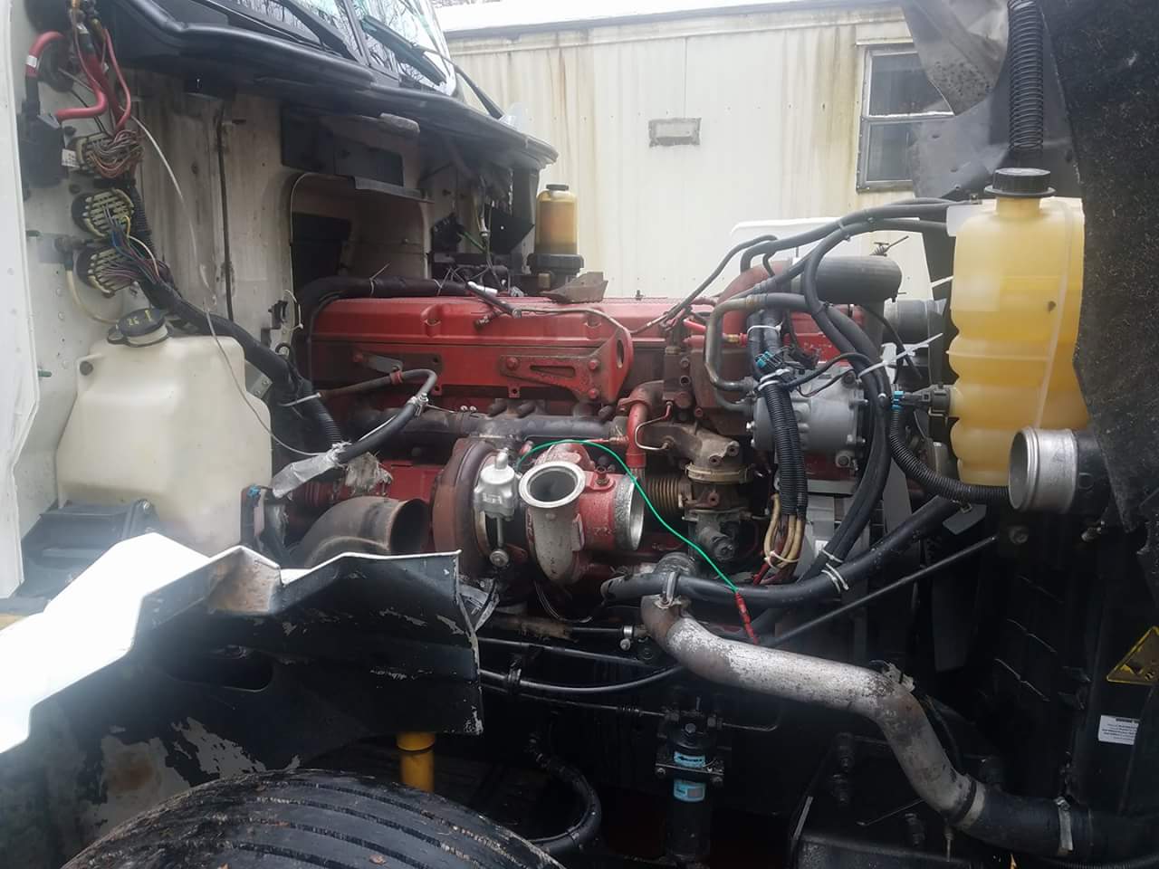

    Would be easier to buy my own but don't really got a place to store them unless i leave them outside. The house we rent doesn't have much storage;/ Im gonna attempt to drill out the center a little then use a left drill extractor after i put some heat and hopefully it will come out. If not ill have the guy that help me with my water pump come out.. I mean i could put it all back together and drive it to a shop but then im look at 6 hours of labor just to get to the bolt when i can pay $200 to have someone come out and remove it:p

    do not try to easyout it hot. once you drill it out that kind of relieves pressure . Take a plat punch and whack it hard a few times to shock it loose with some penetrating oil and then use an extractor. Be carefull you can"t drill out a broken extracter easy.. Good Luck

    Tool rental maybe. If you weld a nut to it you get the benefits of heat and leverage
