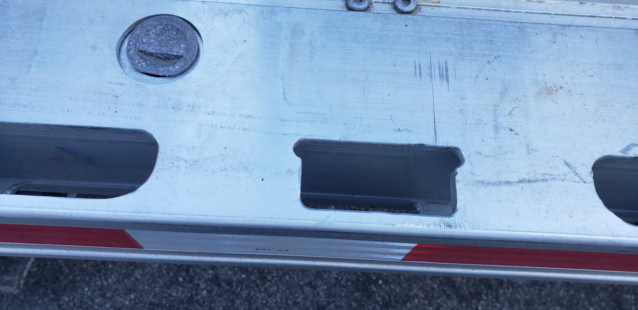

    These New Fontaine trailers almost dont have a "rub rail" ALmost like it has holes built into trailer for straps and chains to go through... Kind of different...
    I just picked up this trailer from a guy who's broke down... Started here 2 weeks ago, this is his second load and hes been sitting at this shop for a week, talk about bad luck... According to him they still dont know what's wrong with the truck??? Hes been sleeping in the truck. I think I'd be finding another shop, when I picked up the trailer his truck was parked out in the shops trailer drop area... Kinda odd. I would think it should be in the shop being worked on or something.... 20190305_155015.jpg

    Best " rub rail" ever. I really like them.
