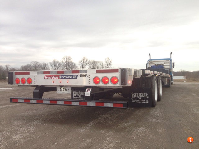

    Btw, anyone here pull one of Mercers steps? My trailer won't build up enough pressure to raise the deck when trying to open or close the spread when I'm loaded. If I'm empty, it lifts up in 15 seconds but if I'm loaded its a no go. I've tried it with a 40klb load, a 35klb load and my current load where in only 26k on the trailer axles. Do I need to go to a shop or is this normal?[​IMG]
  11. Flightline
    Flightline Road Train Member
    2,345
    1,167
    Oct 1, 2011
    Almost There
    It's cause you didn't send in any koolaid coupons with it. LOL
