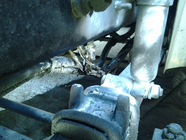

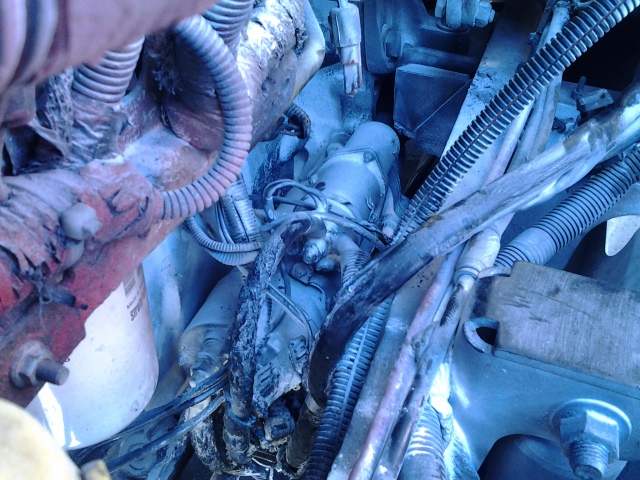

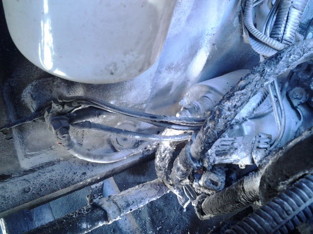

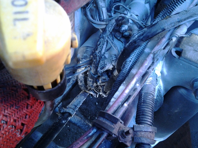

    Well I got lucky this morning. I was sleeping when the engine quit, got up the see the stop engine light flashing weirdly but no alarm. I figured I would have a smoke before I got dressed to see if I was low on coolant or whatever caused the shutdown. To my suprise I looked at the truck next to me and saw a reflection of FIRE coming from under my rig. Boy I tell you I never put on my pants and shoes so fast in my life. I got out, got the hood open and got the fire out pretty easily. But I don't know why the fuel line which was in the flames never melted. Or for that matter whatever wire melted to kill the truck I am very lucky that I seen it when I did. So here I sit in leary, tx waiting on the mechanic to see how screwed I am. I can see that it started under the starter, on of the main cables is completely melted apart. Thats probably why I could put out the fire so easily. Man there is a lot of melted wires under there. Anyways I am very grateful the someone was watching over me this morning, it could have been a whole lot worse. I will update you guys when I find out more info.

    monkey, do you have a c15 caterpillar? if so check the fuel line that comes from in back of the head around to the filters area, above the starter, the clamp there on the rear of engine toward the firewall is known to rub a hole thru the fuel line at the point where it bends around the block, this will leak above the starter. its fairly common, happened with mine and everyone of my sons 5 concrete trucks with the cat engines. worth checking

    Well after the loves mechanic and two other indy shops refused to work on it because "I won't touch electrical work on a international", that gave me the kick in the butt to tear into it myself. It looks like the ground lead and one of the hot leads that were bundled together just wore a hole in the insulation and arced. I the the ground cable was already melted completely through by the time I got the extinguisher on it. Once I seperated everything, I could see that the two cables were the only ones that shorted. Luckily the 5 smaller wires had the insulation melted off but still intact, so I just taped those up. I cut out the melted pieces of the big cables and spliced the together along with some 2 gauge with that loves had for extensions. I was shocked when I hooked everything up that it actually started. It is going to cost me either way but I chose to bounce home to a mechanic I trust. Ther is a lot ofwiring to be replaced. Here is some pics. 20150429_093107.jpg 20150429_092939.jpg 20150429_093040.jpg 20150429_092931.jpg

    man!!!! at least you got it going. in the long run, getting to someone you trust will be much cheaper in the long run
