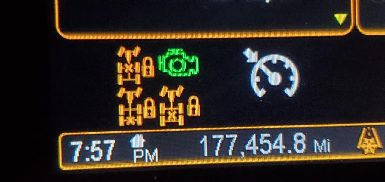

    Personally i think that's a horrible idea to drive in crappy conditions fully locked. If you lose traction things are gonna go sideways really fricking fast.
    I rarely even run with the power divider locked in snow or ice, unless there's a big hill coming in nervous about making. And honestly I never feel much improvement in traction with it engaged
