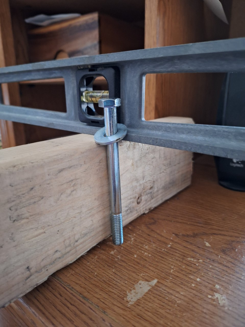

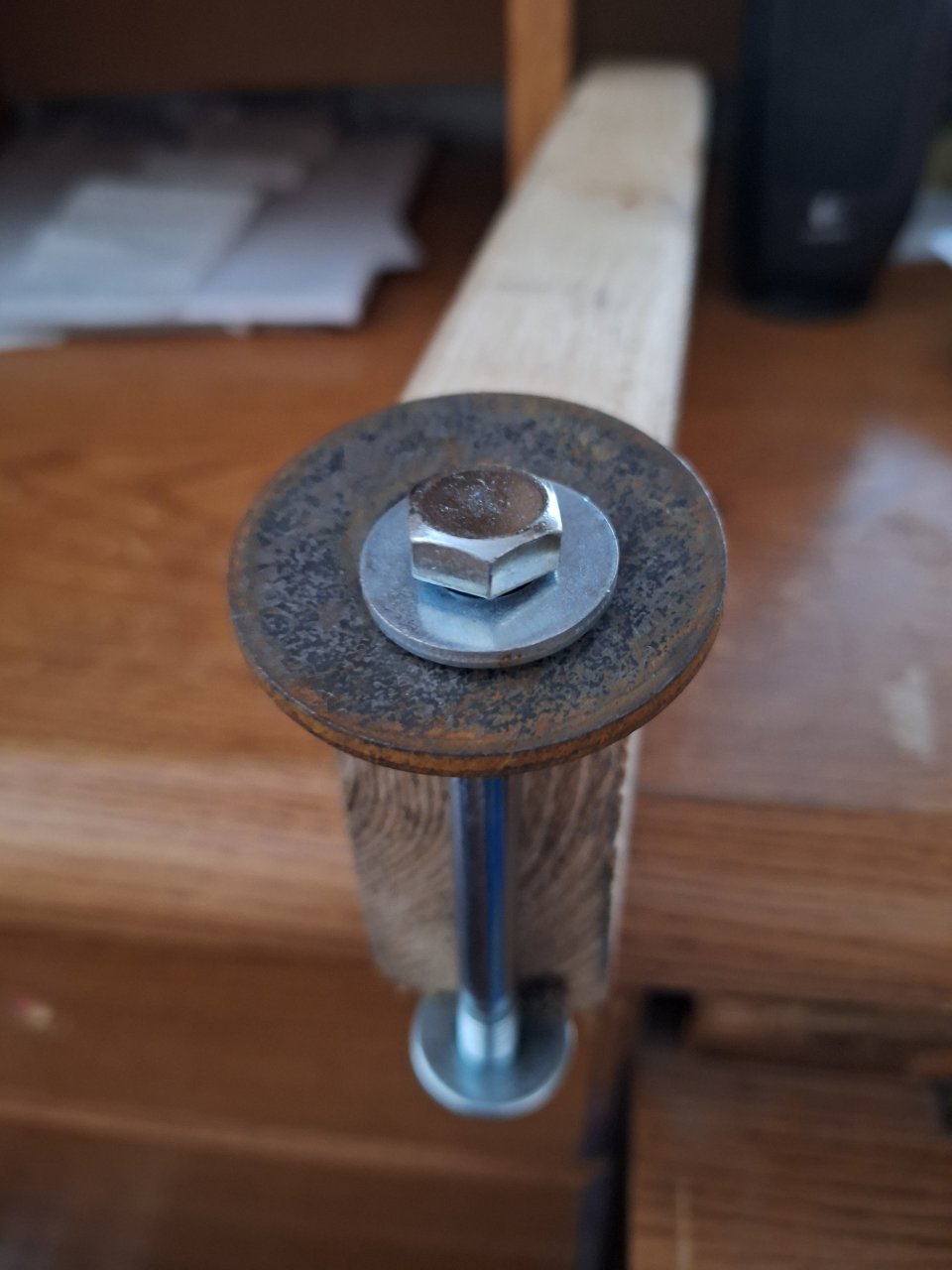

    To secure the building to the I-beams. Put 1-1/2",,2" lag bolts beside the beam flange in to the center of floor joists, with an oversized washer getting pressed between the bolt head and the flange of the I-beam.
    Bolts on both sides of each beam works best.
    Bolts go in center of floor joist.
    I grabbed what I had close by to illustrate.
    The level in picture is the I-beam. 2x4 is the floor joist.

    And weld all the I-beams where they overlap. Easy to grind off after using.
