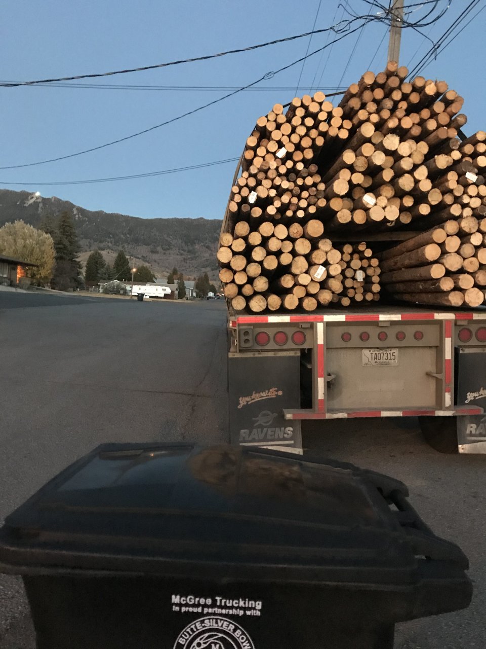

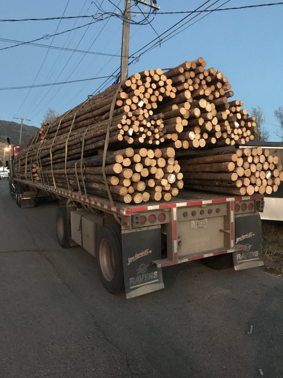

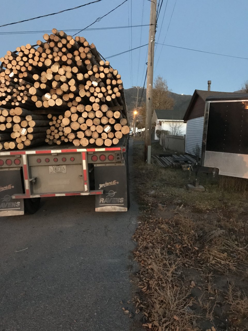

    Went to pick up this load that was supposed to be lumber. Apparently we are using that term loosely these days. Anyways it’s 16 bundles of 21’ 3” trees. It started out legal width, but within the first 20 miles it settled out to 107” at the back. I have two belly straps over each layer of the bottom two stacks, plus four over the top of each complete stack. Total of 16. Tighter than hell yet things still moved out. Should really have stakes on the bed to make life better, but once again this was supposed to be a lumber load. Decided to play it safe rather than chance the DOT not noticing. Bought oversized permits for Montana, and Idaho since I’m going over three scales. Hopefully it doesn’t move any more.

    You cannot permit a divisible load for width. You are not clear of the scales.

    Kudos to you for the overwidth permits - but @bacoman is correct.
    SOLID pipe stakes would have contained it.

    That's a guaranteed self widening load. The crowder unit in the middle will exert side force on the two side units every time you tighten the straps and pull down on your top unit.
    I see you gut-wrapped it. That usually helps but once it starts to spread out it's hard to stop it.
    We haul a lot of stuff like that and we use stakes to hold the sides in.
    I've seen them hauled without stakes but the units are usually individually banded and stickered on every level.
    I think I'd throw a few extra straps just to hold the logs when they really start to pooch out on you.

    Cinch strapping should have helped keep the bottom together... But looks like regardless the top was going to spread put...

    I'm surprised that the shipper loaded him without stakes.
