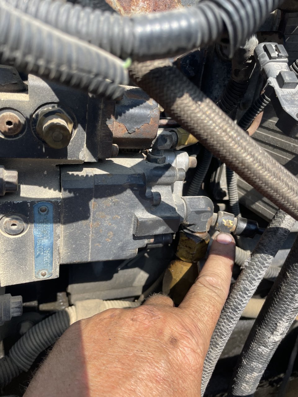

    I was wondering what this is used for on the 90* fitting going to the pump? IMG_4173.jpeg
  4. Big Road Skateboard
    7,112
    40,372
    May 2, 2021
    That's a CompuChek fitting. Used for reading pressure. No, not all 14's had the check valve. Would be on the output (front) of the cooler plate. I've installed quite a few where from the factory was none.
