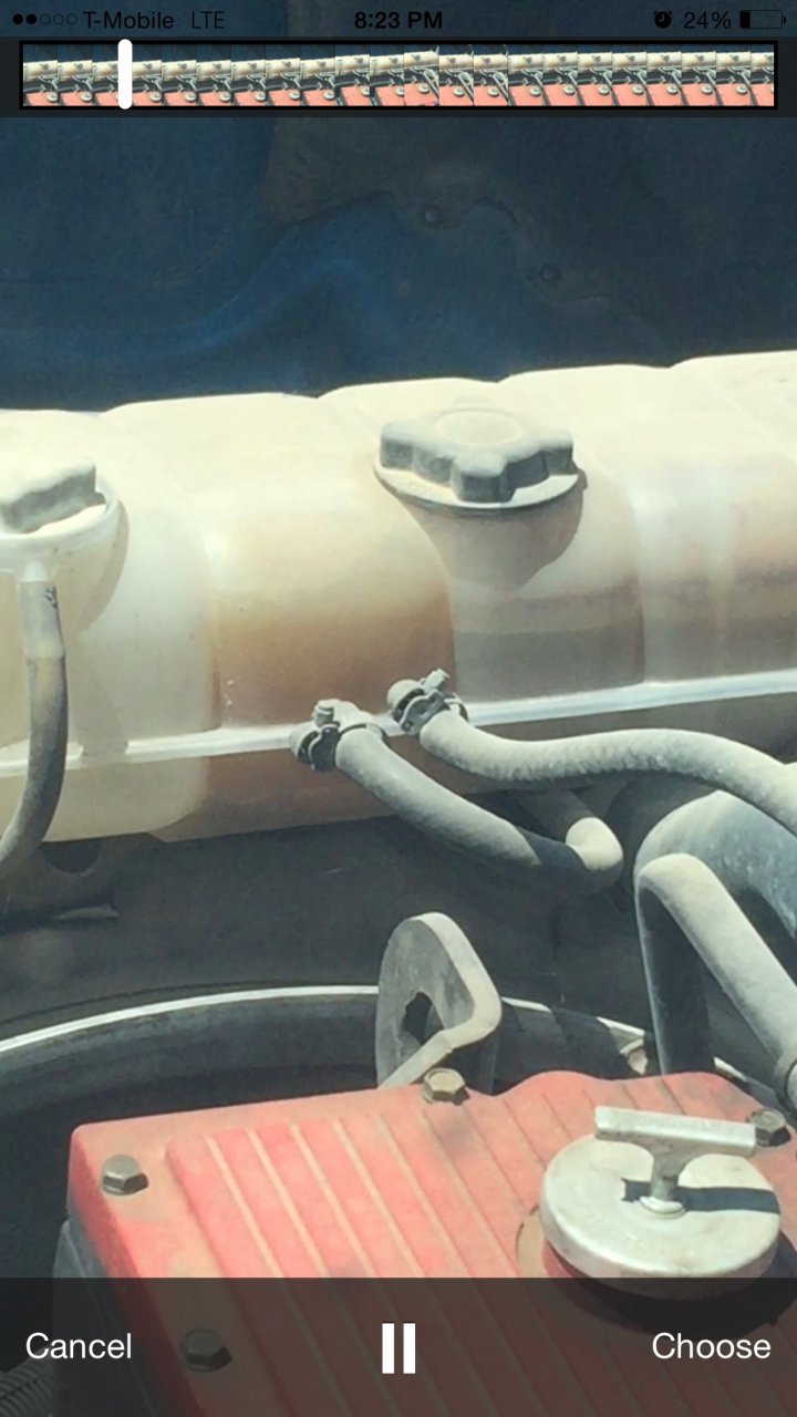

    hi I'm about to buy a 02 volvo 10 with n14 Cummings select plus red top I was checking out this truck but I saw that the water moves in the anti freeze tank it doesn't leak it just moves is this normal?

    Our Cummins engines have a return back into the reservoir. It's not like the old days where the reservoir was just an overflow collector, todays engines include the reservoir tank in the flow cycle of coolant.

    I drove a 98 International with the same engine, and 1.1M miles. It did the same thing, with a steady stream of bubbles. Oil analysis showed no problems after the first oil change, and it never lost coolant. Seems like that's normal for the N14.

    Thanks guys for the help I wasent sure why it did that
