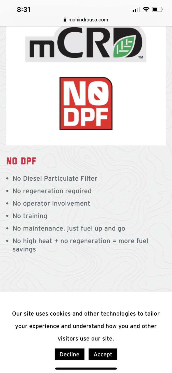

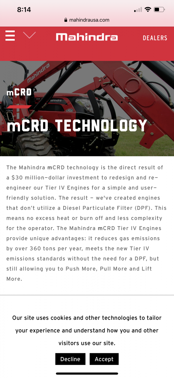

    I can see that possible someday soon.
    Mahindra tractors aren’t using dpf to meet emissions. Technology will soon get rid of that nonsense system

  9. Chubby Fly
    Chubby Fly Medium Load Member
    569
    797
    Nov 25, 2019
    I was reading about the mahindras motors about a year ago not using dpf. I think it’s great and I’m sure others do as well. Just checked their website. The biggest motor they have which has no dpf or regen is 120hp
