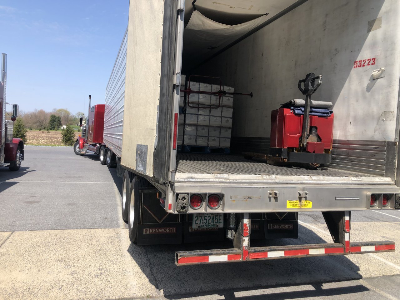

    electric pallet jacks are the way to go,
