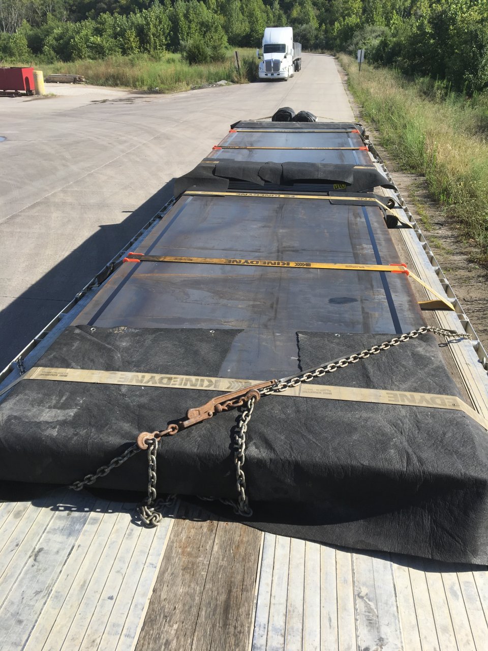

    Like this chain. Some guys use two chains but I have found one works just as well. It's only snug and not intended to be a securement device.

    What exactly is the purpose of that tarp at the front? I don't usually see smoke tarps on steel loads...
  7. mitmaks
    mitmaks Road Train Member
    2,586
    2,102
    May 16, 2014
    That's to prevent damage to the actual tarp. Those steel plates have sharp corners and if you don't pad edges like he did, your tarp is going to be all shredded up.
  8. ChaoSS
    ChaoSS Road Train Member
    3,338
    6,758
    Sep 20, 2014
    Guess I was just assuming that load wasn't getting tarped...
  9. kylefitzy
    kylefitzy Road Train Member
    4,753
    19,806
    Aug 12, 2007
    Kansas city,Mo

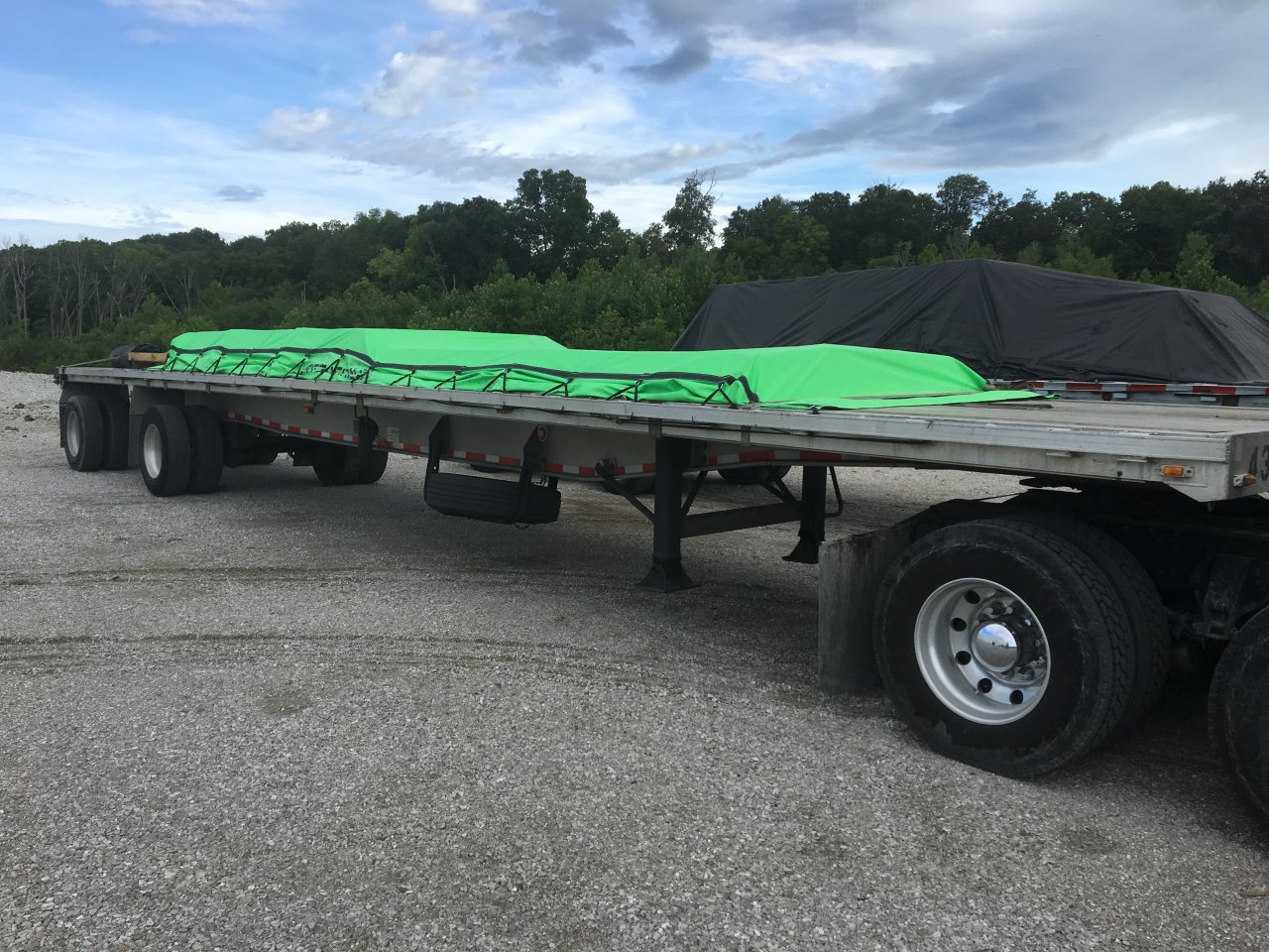

    Yep it's felt padding for the tarp. Similar idea but different loadin the second picture.
