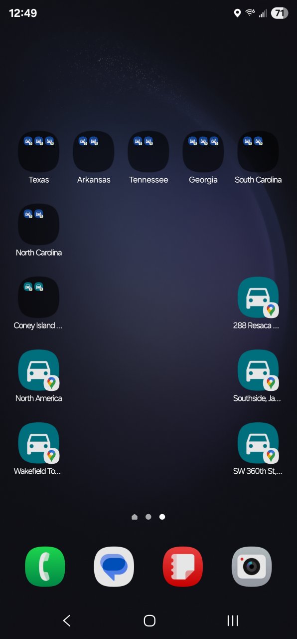

    I've used nothing but Google Maps for routing for the last 13 years of OS/OW. You can build your own routes in Google maps by using dropped pins and then save them on Android phones. For complicated routes you might have to do it in multiple sections since Google maps is limited to 10 waypoint pins.
    I just save all the sections on a separate home screen in folders for each state if needed. Easy to pull up and easy to share with my escorts or other drivers on the same job to save them the time of entering the route themselves.
    All those state folders on this screen shot are for one job I did. Probably 130-140 waypoints total to get Google maps to go the way I wanted.
