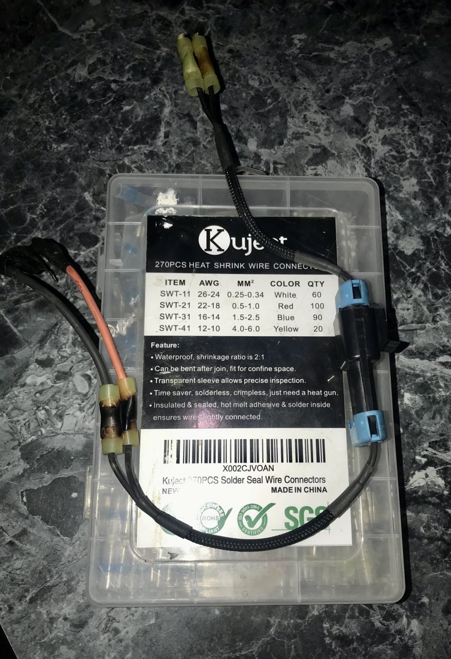

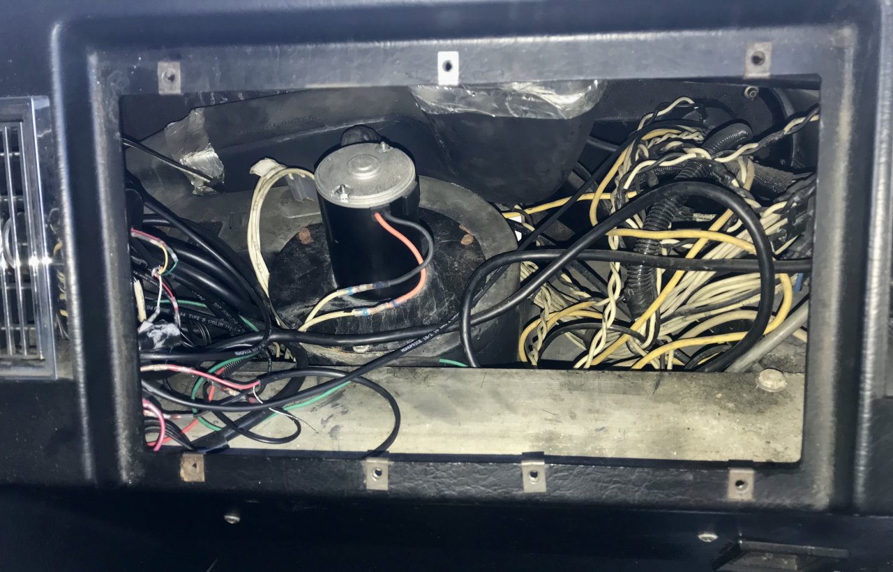

    Mine stopped yesterday.
    Located behind the glovebox bucket. I had replaced mine for 'why not now' reasons last year. This is after I cut out the other 'fixes' and used Kuject connectors. (On the road).
    Somebody had a good idea and used a weather pack connector, but the wires were around 18-20 gauge. Then the two sets of butt connectors (crimped) - the black taped section was when I replaced the unit, soldered and wrapped.
    It quit on the drive, and a wiggle of the blackened butt connectors revived it till the days end.
    My advice is to direct solder if possible. I use a little propane torch.
    The wires on the new motor are red-power black-negative, but I see that using a voltmeter - and changing speeds 1-2-3-4 - the power shows 12V, but the black wire records voltage increasing from 4-3-2-1.
    Somebody smarter can probably explain, but I'm guessing that the resistor in the fan control is responsible for this.
    Even with fan motor off, voltage is still supplied, so remember to key off before connections.
    And I'm guessing this would explain the overheated burnt butt connections.
    More explanations and advice welcome.

    Ohms law is V (volts) = I (amps) x R (resistance) so I = V/R Let's say V is constant at 12 volts. I = 12/R so the higher the resistance the lower the amps and the slower the fan runs. Different resistance for each fan speed.
    Regarding the black butt connectors. I was going to say that someone tried to heat them but looks more like burnt from the inside. High resistance due to a poor connection will cause higher heat and the burn marks. Or a fan going bad drawing too much (more than normal but not enough to blow the fuse or breaker) could have caused the connections to get hot resulting in the burn marks.
    Look closely at the Kuject box under Feature. The 4th bullet point states 'solderless'. Bullet point 5 states in part: ...'hot melt adhesive and SOLDER inside'....
    LOL

    That’s about what I expect from China!
    There’s a very thin amount of solder in there, I like to soak the wire solder in connections and use heat shrink tubing at home.
    I left the copper strands untwisted and shoved them together inside the Kuject.
    I was initially confused by the voltage reading on the black wire at different fan speeds.
    Must draw some power - all those connectors were pretty warm.

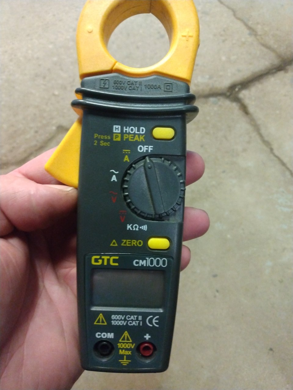

    Now you’re going to have to teach me how to measure amps - set meter to resistance?

    Ohms for resistance is checked with power off, disconnected. Otherwise will blow the fuse or fry the meter. Voltage is checked in parallel. Amps in series. Amps usually checked with an inductive clamp such as on a load tester or the newer type capacitance testers for an alternator. If using a meter say for alternator amps you would have to disconnect a wire from the alternator and one meter probe would go on where the wire was disconnected (stud) and the other on the end of the disconnected wire. The meter probes are between so that amps runs through the meter.

    With a clamp meter, they sell cheap ones at Harbor Freight.
