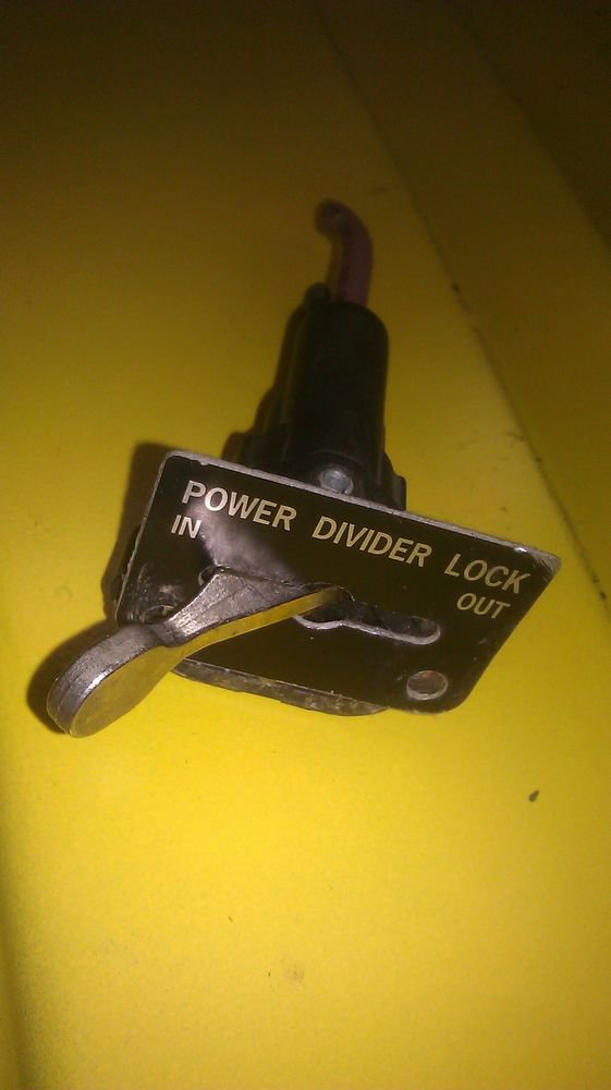

    The very first thing CDL schools and training companies need to do when a student gets behind the wheel is explain what all the switches do:[​IMG]
    Inter axle Diff = power divider. You can engage it at highway speeds as long as you're not spinning the tires:[​IMG]
