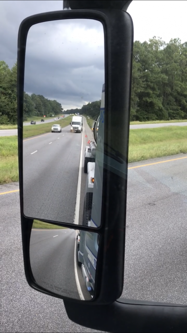

    I keep em about like this

    In horrible honesty - there’s been a couple of LS drivers that had their contracts canceled due to photos like these.
    Dan.S and shogun Thank this.
