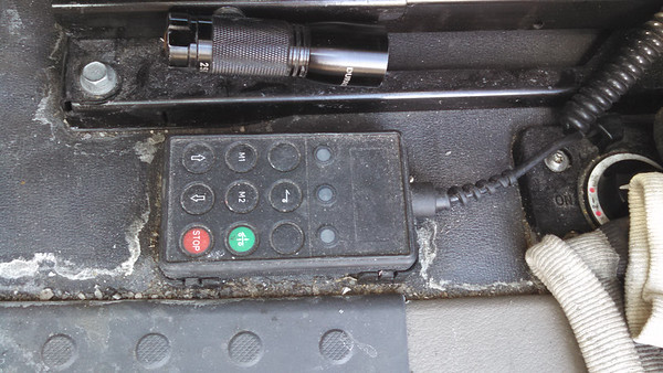

    Engage the air deflate control. whether it is a rocker switch on the dash or a handheld type remote on the floor.
    Depending on your tractor's build, you may not have the option.
    I had a loaner cascadia that had this remote type control attached by a coiled cord positioned on the floor on the left side of the driver seat. I can only assume it was intended for the driver to be outside the truck and monitoring the air dump.
    It took a while to figure out the routine. I had to press the button that looks like a music note then use the up/down arrows. I only ever used down because it would auto-inflate after the truck was in motion for a moment or two.
