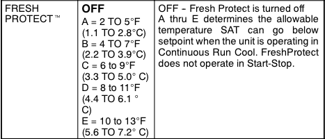

    I was mistaken. "Fresh Protect" is buried in the "Functional Change (Parameters)" menus, along with a number of other settings related to how the unit operates under various conditions and settings. This is exactly where you choose how far off the return air temp the unit will permit the outlet air to vary. You don't change the temp values, instead choose one of the A-E presets.

    If I want to set it for 55*F, with my fresh protect set to "B" or "C" (it was on "C"), set it for continuous, it's going to walk it down for me instead of redoing it every 5-7 degrees.

    That's how mine was behaving, probably due to age and a broken condenser fan shroud I am having repaired at the moment. However, the way this reads, the unit should run below the setpoint, not the return air temp.
    So for example, start on a 100º day and set at +55º on setting "B" you will get discharge air temp between 48-51º until the return air temp approaches the setpoint. Then there are other parameters that determine how rigorously the unit tries to stay on top of the setpoint.
    So managed to clear my own misperception by RTFM LOL
