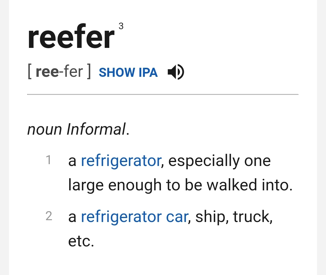

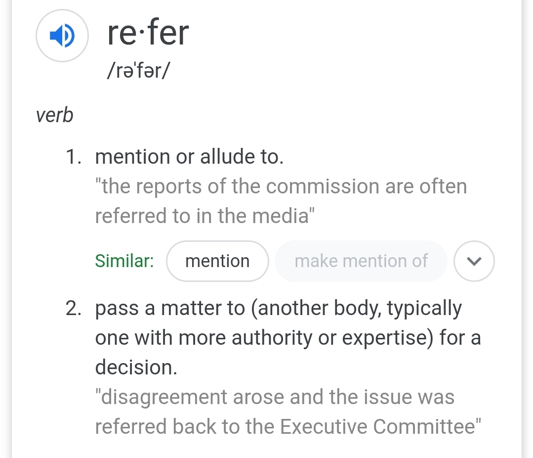

    How come you refrigerated guys don't know how to spell the type of trailer you drag around?

    Because he wanted someone to REFER him to a certain kind of REEFER.

    Quite honestly it just takes a lot more work to add a second f into the word lol
