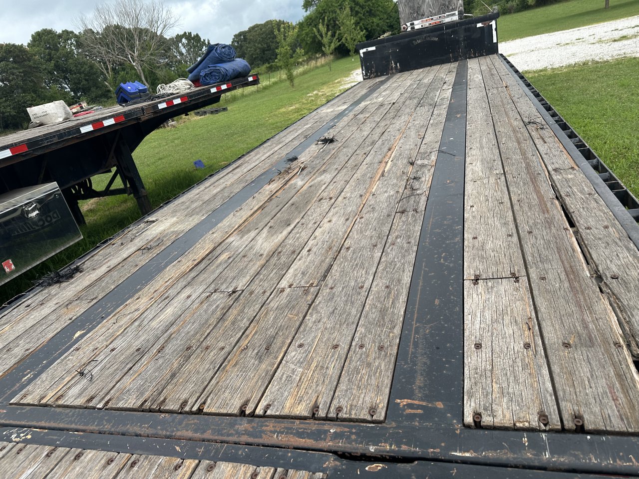

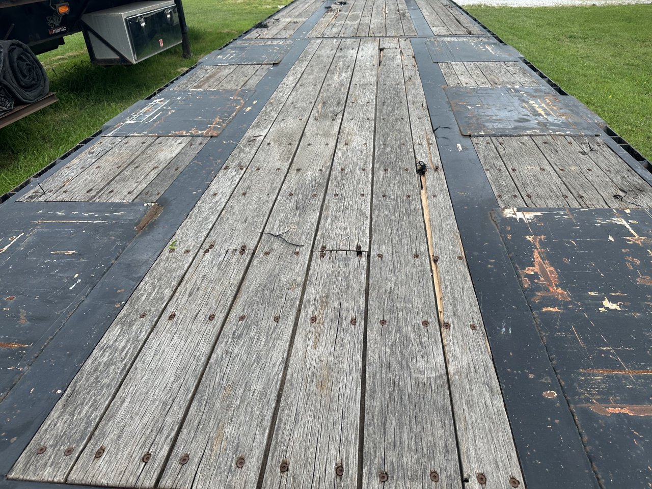

    Start this off on the laptop, so I can patch myself on with the phone to attach photos.

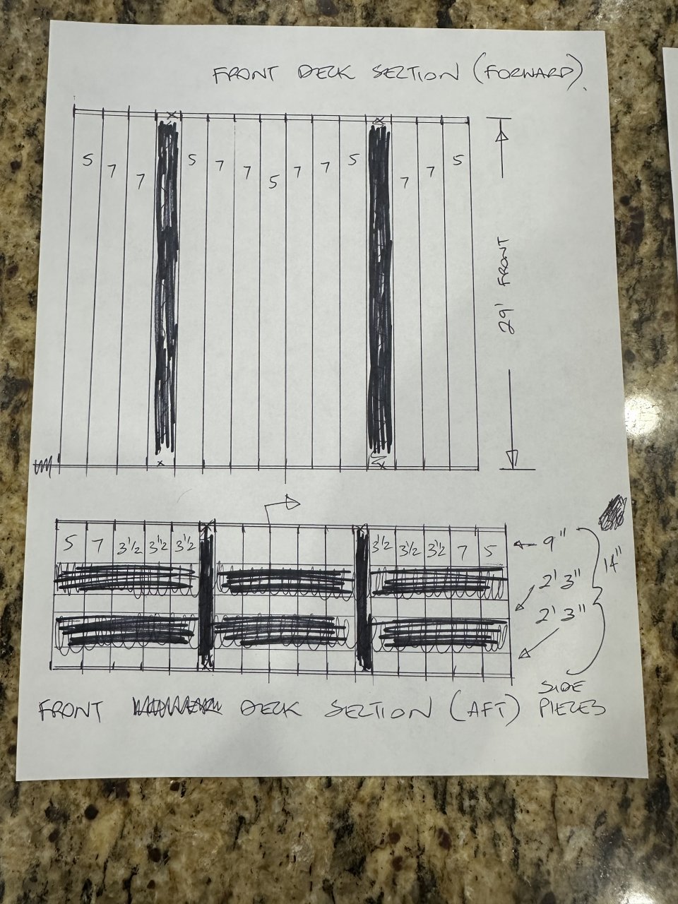

    2015 Doonan Stretch Step Extendable, needs decking replaced - photos and jerry rigged schematics on board length and width etc to follow.
    Called TNT and they're about to get back to me with a quote, after some advice on 'DIY' or 'Send it off and pick it up'.

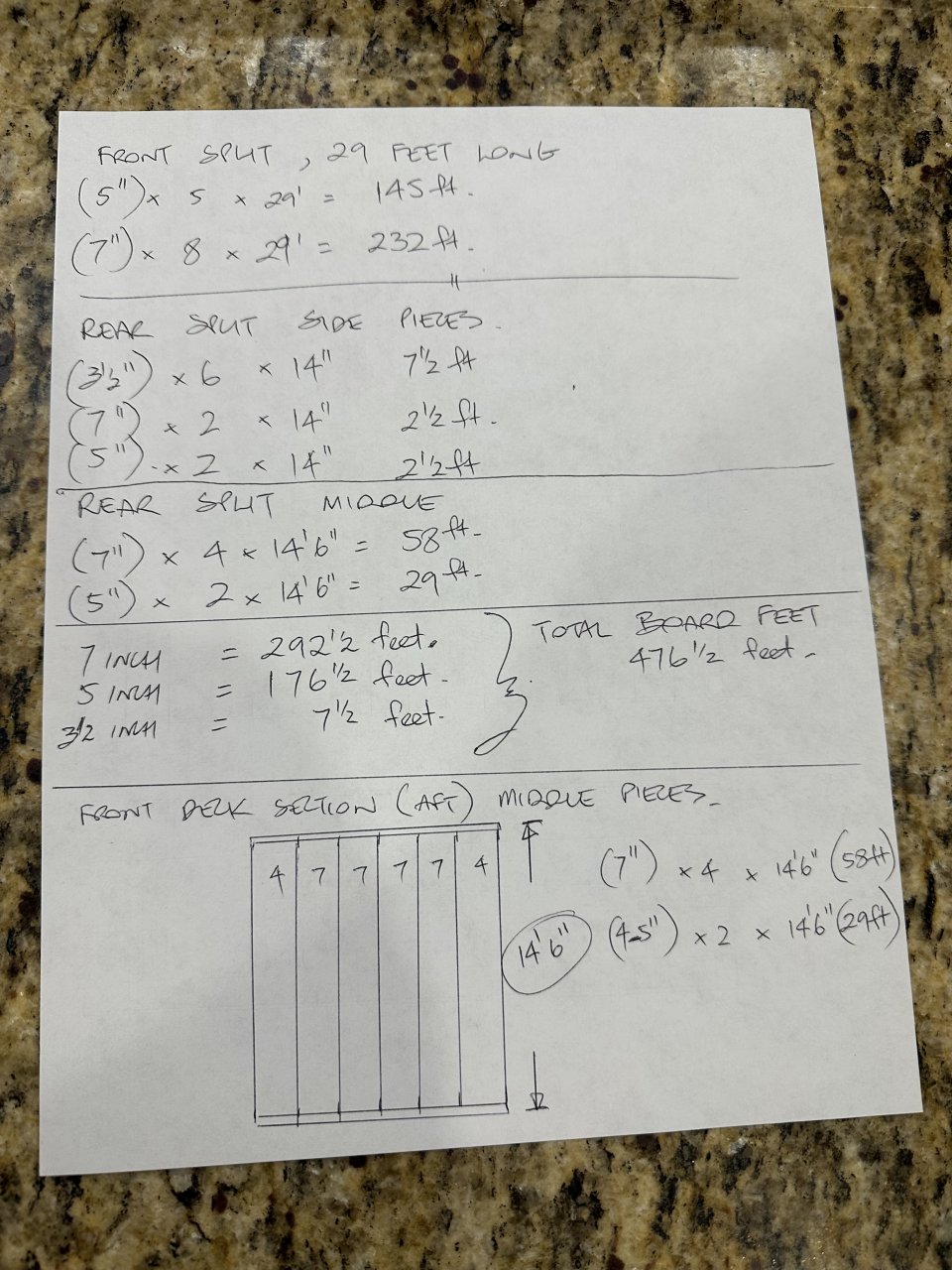

    About 300' of 7" wide and 180' of 5" wide apitong, shiplap.
    Hack off the old, cut off wheel and grind, then repaint crossmembers, and replace cut to fit , new deck.
    Is it worth trying to do it myself, or better off to send it to a place that does it all day long?
    They ESTIMATED 40-50 hrs labor @ $115/hr for the job.
