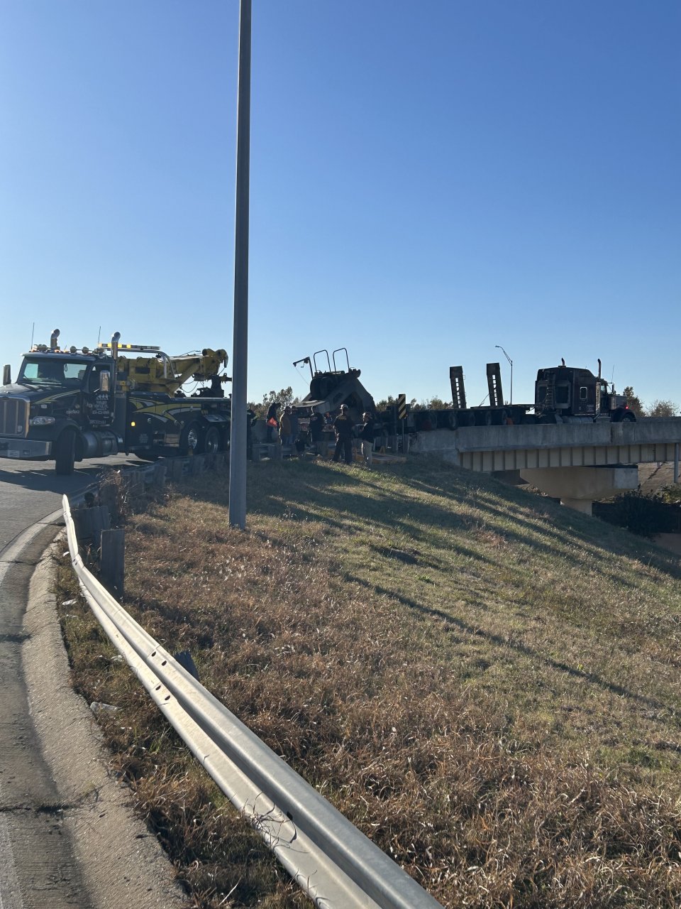

    Here’s what happens when a stretch rgn goes off route . Not very fun or forgiving trailers

    Looks like he forgot he was pulling a trailer. Drug the axles right over the concrete walls as if they didn't exist.
