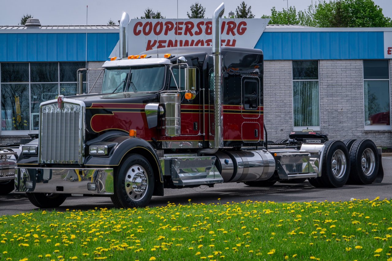

    The problem with hanging out at a Kenworth dealership for a week is too much eye candy. lol
    14274FA7-9727-4A5D-944E-947DE5F2DB98.jpeg 0112E6AB-63CA-44C0-8F71-01709E401440.jpeg 631DC674-D604-40CB-AC04-F7B221C8DAC4.jpeg

    7 days later they now what's wrong with my truck. Should have the part in tomorrow and I'll be rolling tomorrow night. 9 days out of commission for a seemingly easy nothing wrong regular scheduled maintenance..
    It was a slightly warped injector washer. Came out of the factory like this. Causes the engine to blow white smoke out of the exhaust ever few months or so burning off extra built up fuel. But besides those times there's no signs of anything being wrong. No smoking or check engine stuff. Nothing but running great.
    So for the first 100000 miles in this truck, every time it did this I went to Kenworth or JCT saying somethings wrong. It's blowing a ton of white smoke.
    Response to this was always, it's not now. It's running fine and passing all the test. Have a nice day. lol
    So I guess I'm happy it completely filled the Coopersburg KW shop up with white smoke last week...
