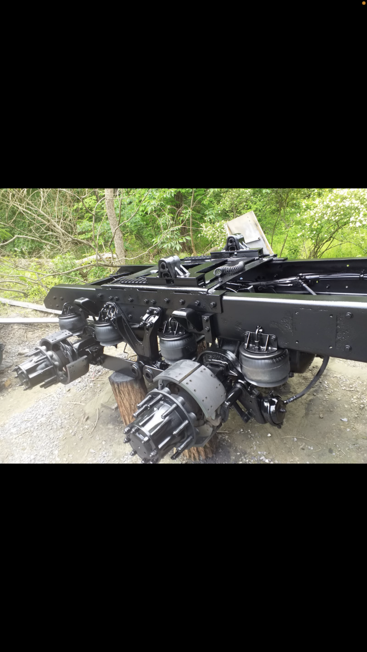

  4. Mcast3092
    Mcast3092 Light Load Member
    137
    107
    Jul 31, 2018
    I took off the tires and brake drums and did just that lol. Thank you.
    Rideandrepair Thanks this.
  5. Mcast3092
    137
    107
    Jul 31, 2018
    642C12A4-00EA-4774-BF7A-DF660F3E17E6.png Here’s the finished product
  6. God prefers Diesels
    4,198
    22,267
    Jun 26, 2020
    South Texas
    Geez man, that looks AWESOME.

  11. Rideandrepair
    17,578
    56,942
    Aug 8, 2015
    Wow!! That frame looks good. Great job.
