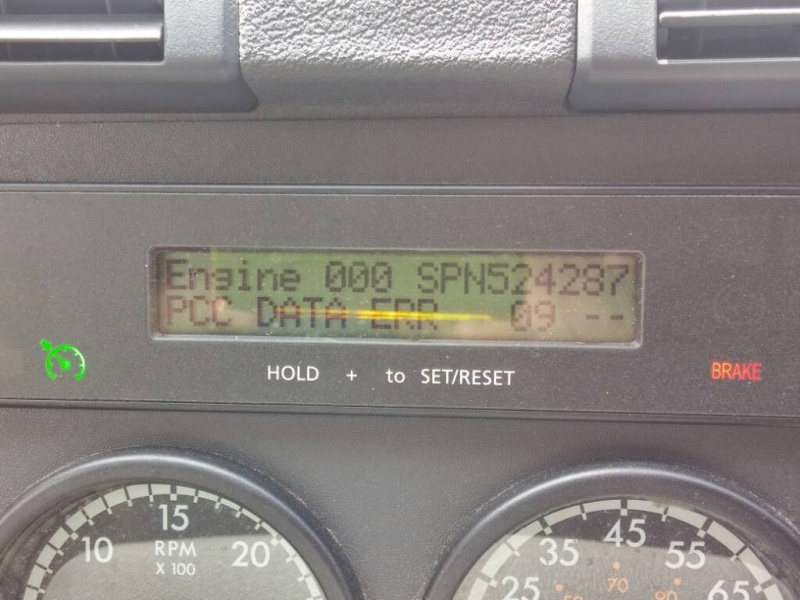

    Hey DFO What is this code? SPN524287 PCC DATA ERR 09 uploadfromtaptalk1402958982241.jpg

    Hey moosc looks like it is related to predictive cruise control, do you have that on your truck?
    Here is what I could find for that one:
    SPN 524287/FMI 9 - EPA10
    This diagnostic is typically predictive cruise control message not received.
    1. Check for multiple codes.
    a. If Common Powertrain Controller (CPC) SPN 168/FMI 0/14/18 (Battery Voltage) are present, troubleshoot those
    first.
    b. If only SPN 524287/FMI 9 is present, go to step 2.
    2. Clear fault codes, start engine and idle for one minute. Does fault become active?
    a. Yes; go to step 3.
    b. No; release the vehicle.
    3. Is the vehicle equipped with Predictive Cruise Control (PCC)?
    a. Yes; ensure CPC parameter “CC Mode Selection” is configured properly (refer to A and I Manual for appropriate
    setting). If setting is correct, go to step 4.
    b. No; ensure CPC parameter “CC Mode Selection” is configured properly (refer to A and I Manual for appropriate
    setting).
    4. Check power/ground and J1939 connections at the PCC Module. Refer to Original Equipment Manufacturer (OEM)
    literature for schematic information.
    Got that from this link:
    http://www.ddcsn.com/cps/rde/xbcr/ddcsn/1209-10.pdf

    Yep I have preditive cruise. Nothing to worry then. Thanks for the help.
