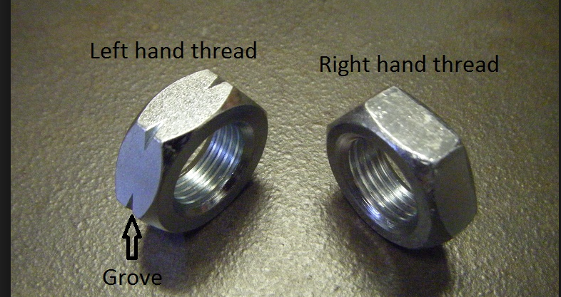

    Left hand lugs or nuts in general are supposed to be identified with a grove in the hex face: Screen Shot 2016-08-28 at 1.58.27 PM.png
