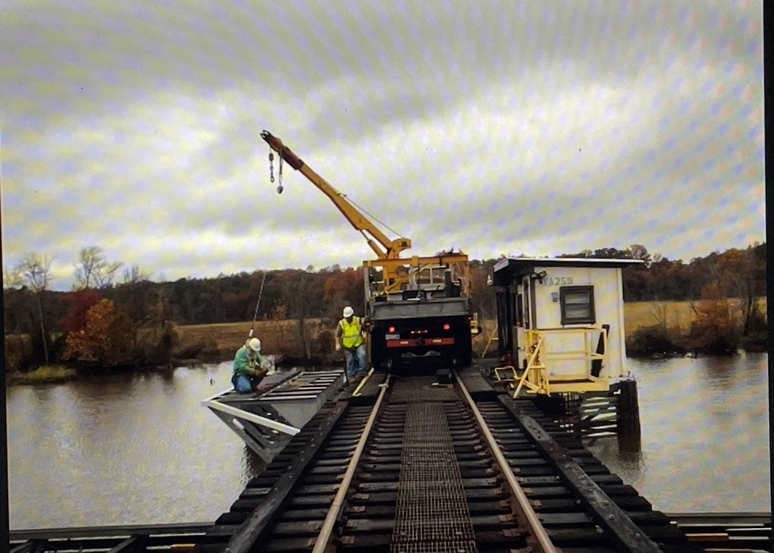

    When I bought this truck from my ex employer it was setting at a marina in Ansley, Mississippi. Been setting close to a year and the storm water had came up to the exhaust manifold which was evident by the grass all up on the engine.
    It was a bear to load on my lowboy with a stuck clutch but I managed.
    After getting it home I hauled it to Charleston to use the boom on a job for my cousin. There was a long concrete driveway at his shop, I got it into 3rd gear and while holding the clutch pedal down started working the throttle up and down quickly using the weight of the truck and the slop in the driveline like a impact against the clutch, it broke loose and has worked great ever since….
