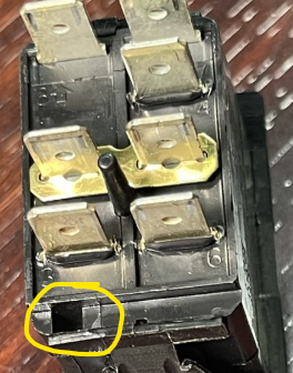

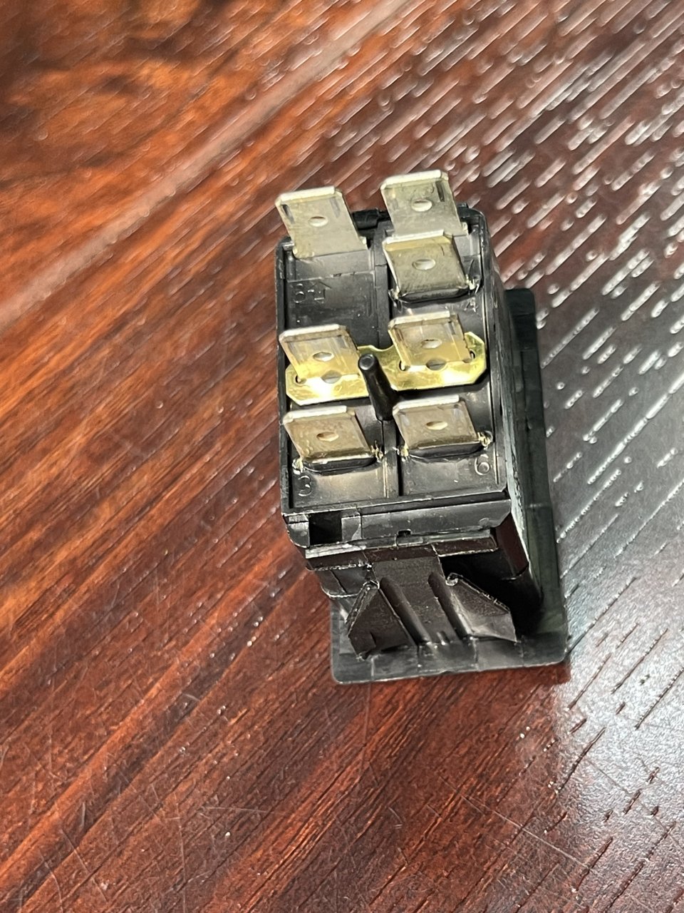

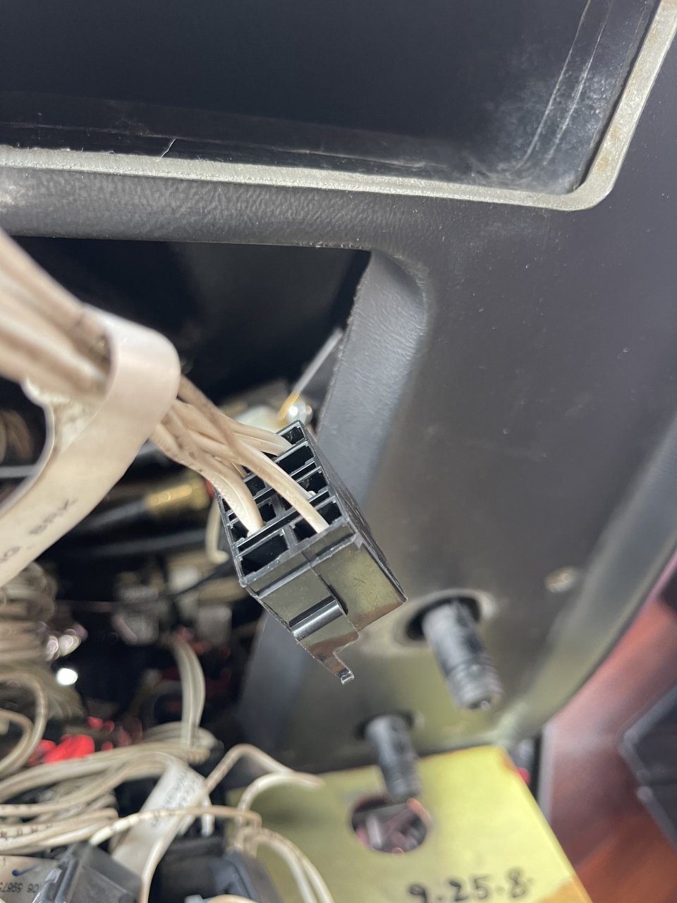

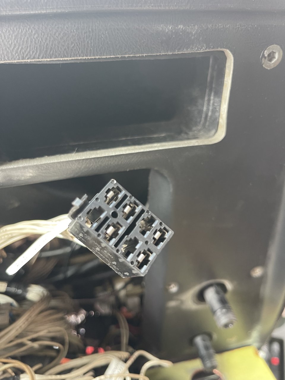

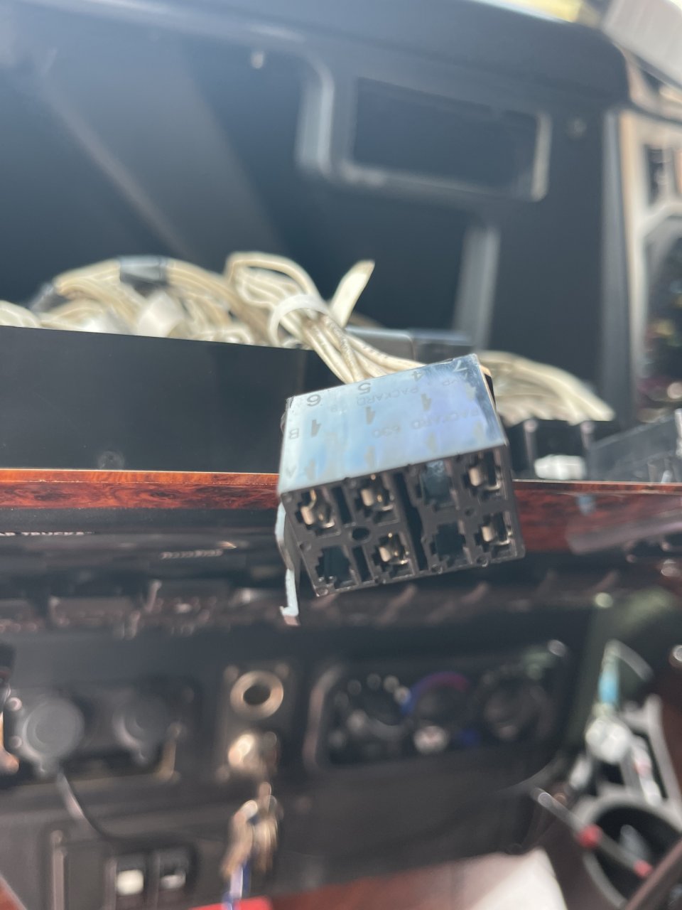

    Post a picture of both the front and back of the switch. Also, a pic of the connector/wires that plug into the switch.

  9. JB7
    JB7 Road Train Member
    1,142
    2,086
    Dec 13, 2022
    Laurel, MD
    Make sure that the piece sticking out goes in the hole. See pics attached. It appears that the plug can be installed either way on the switch, one way of course is wrong. Does the back of the new switch (the terminals) match up with the old switch?

    yes the terminals are exactly as the old switch.everything matches up.i checked the switch it only goes one way.there is like guide pin that goes into the slot on the harness plug

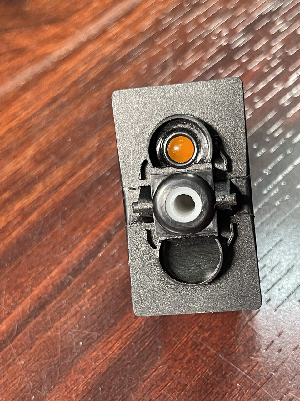

  11. JB7
    1,142
    2,086
    Dec 13, 2022
    Laurel, MD
    Take a small punch or similar object and place it in the white hole of the old broken switch and see if you can operate it, moving it between different positions. If so, I would then plug in the switch, start the truck, and operate the switch and see what happens.
