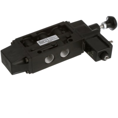

    Can you give me a specific part make and number. I can't find anyone that knows anything about this.

    I normally drive reefer trailers with the pneumatic pins. I have to go back to the tandems to either push or pull the button, depending on which type that trailer has. I have learned that I don't have to go back to release the pins back into the rail, I learned I just have to turn the trailer brakes back off, putting air into the system automatically flips that switch. Then after about 30 seconds, pull the brake back on and either edge forward or reverse for the pins to pop into the holes. That's handy for backing into a dock when I simply have to slide them all the way back. Get out and pull (or push) the button. Go back to cab, pull forward as far as it let's me. Release the trailers brakes again for 30 seconds or so, apply them again. Edge back till the pins pop in, release the brakes and back into the dock. When I'm done and go back to chock the wheels I just check the pins are properly engaged. It's easier than it sounds and both speeds up and simplifies the process.

    Could you link the solenoid?

    K910014 Norgen electric air solenoid with manual over ride.
