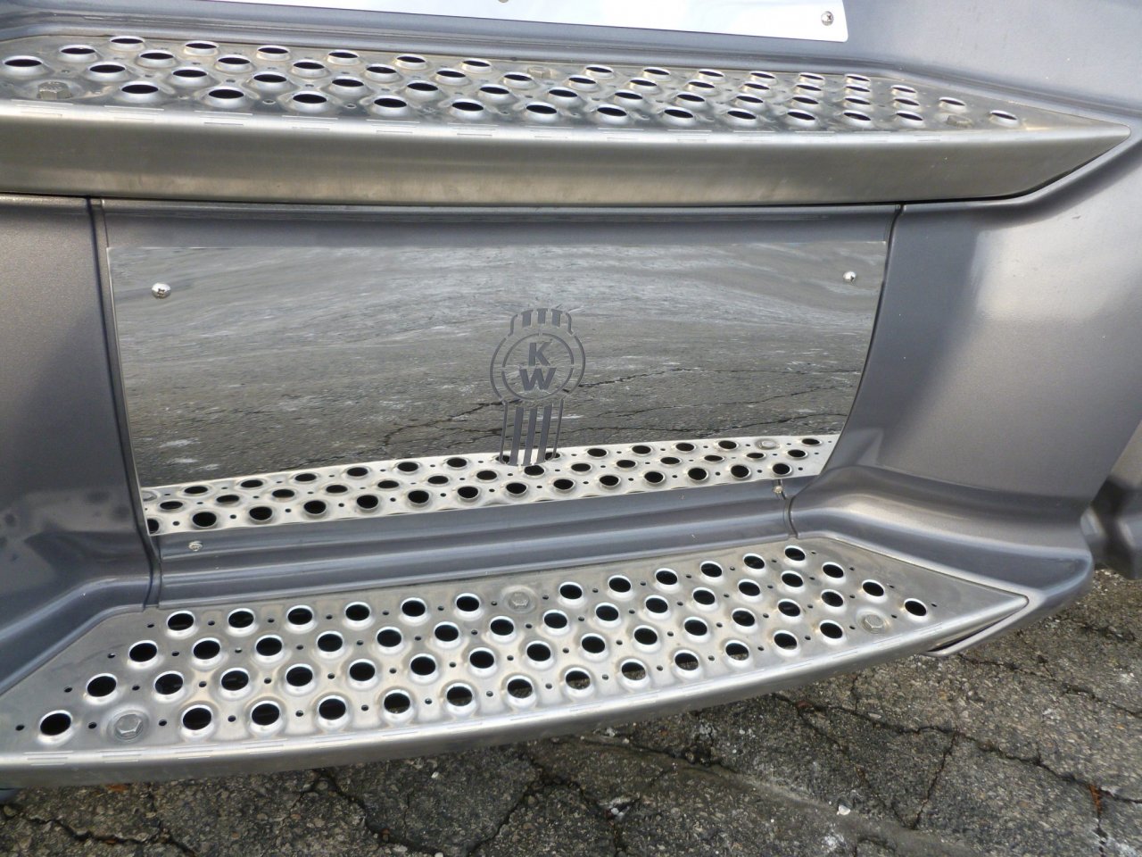

    I know when I was in orientation with transam they showed us a trick for sliding the tandems to the right hole that worked every time with a little stick and the holes on the step rails but it was specific to the t680’s. I was wondering if there is a little trick for a 17 freightliner? So I don’t have to keep getting in and out of my seat fifty times trying to get the right hole.

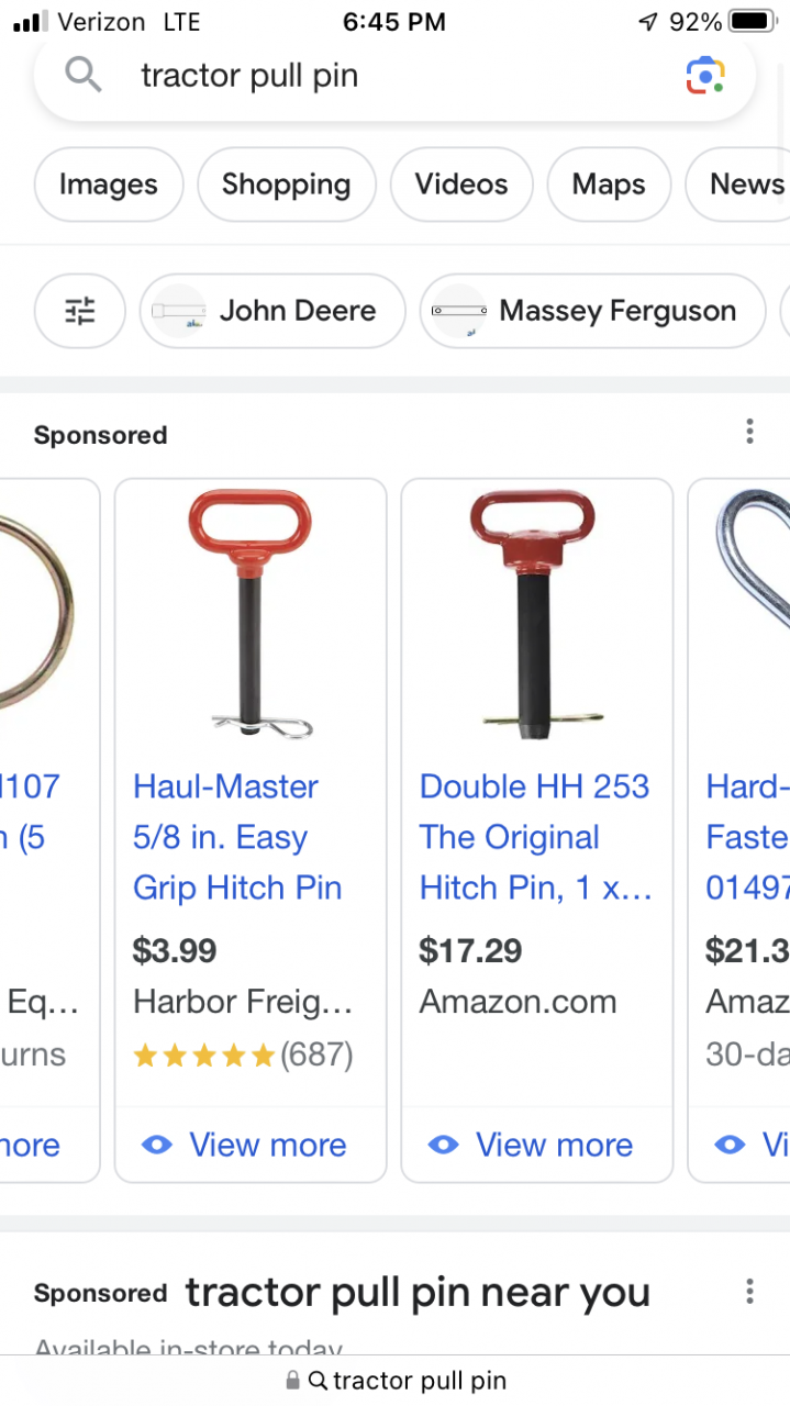

    You could pick up one of these, never used one so can't say how they hold up.
    https://a.co/d/7VagMMo
    Also seen some goofy looking thing foe sale at truck stops to stick in the hole and stop it where you want it but never used that either.

    He’s talking about using a stick and counting these holes, to correlate how many tandem holes one is sliding.
    I’d suggest doing the same thing with your new truck. Just use a stick and have someone watch your tandems for a single hole there and count what you moved on your current step.
