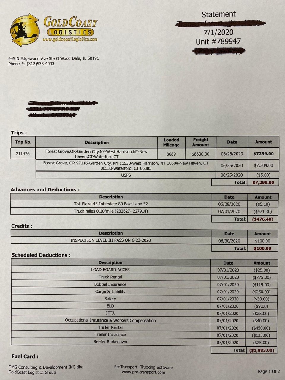

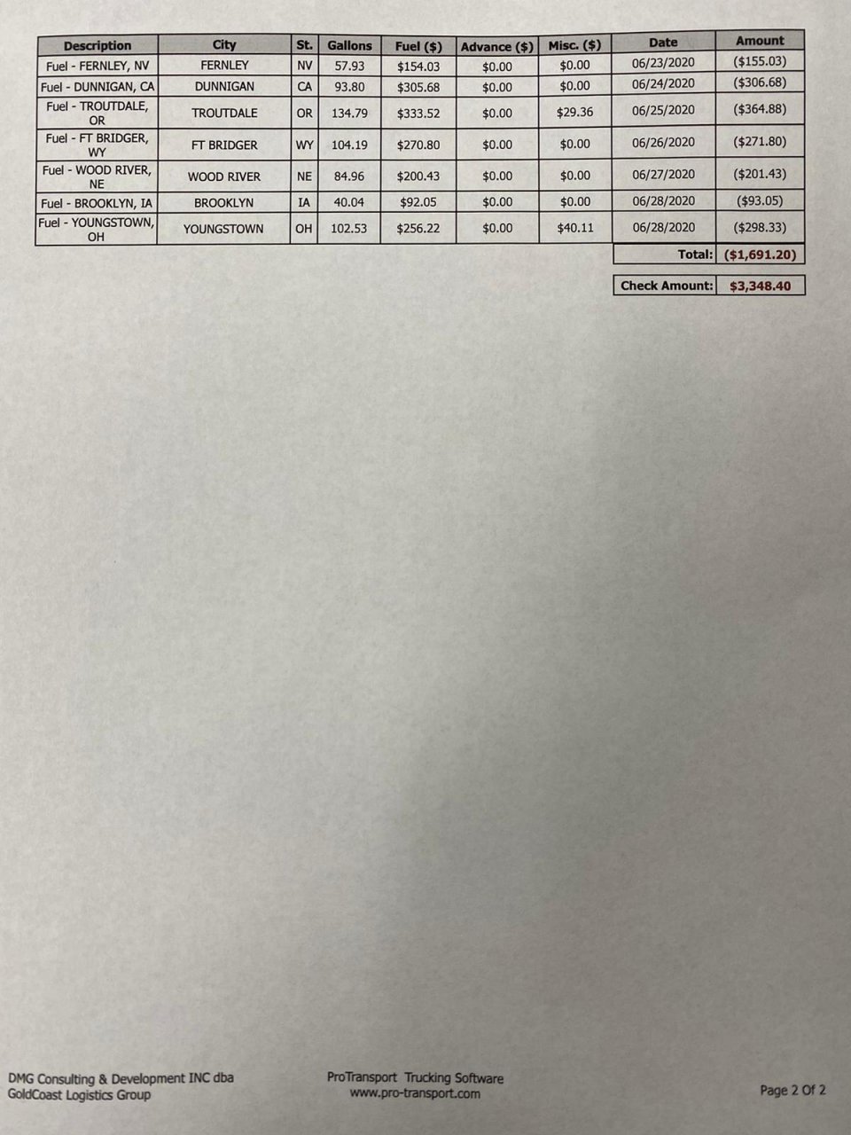

    First time uploading pics. Looks like I hit the button to many times. Anyhoo y’all look at these numbers and tell me what you think. She says she has 250 owner operators that are tickled pink to be running for this company. I’m still trying to figure out where the $1000 went from the freight rate to the settlement rate.

    The base freight rate is 2.36 per mile ($7299/3089 loaded miles) - which is good - BUT - look at the $0.10 per mile deduction - if you do the math, they are charging for 4713 miles - so I assume (?) that is deadhead which is 1624 miles or 34% of all miles - which is very high.
    All the other deductions are quite high too especially Bobtail, Cargo & Liability, Trailer and Trailer insurance - assuming these are WEEKLY.
    Look at the fuel rates, the fuel discount at GCL is horrible to say the least. Comparing my companies discount to Fernley, NV - this driver is paying $2.658 per gallon, my company's rate is $2.05. In Youngstown, OH - this driver is paying $2.499, my company's rate is $2.03. I am using today's rates for fuel purchase this driver did in June - fuel was even cheaper for me then.
    At the end of the week, this driver is grossing $3348.40 - which some would think as a good week - using loaded miles, it's $1.08 per mile - BUT WAIT - you need to factor deadhead miles too - so add another 1624 to the 3089 load miles = 4713 and run that into the net paycheck and you get $0.71 per mile.
    Again - not bad, I have seen and experienced worse but the deductions at this company are a too high for me. Plus, I do not care to drive 4700+ miles in a week to make this amount of money. I drive approximately 2400 per week and net (after expenses but before the tax man) $1.32 - but I own my own truck and the company I lease onto does not charge trailer fees, etc.
    Not sure about your statement - "I’m still trying to figure out where the $1000 went from the freight rate to the settlement rate." - as all the numbers compute for me.
