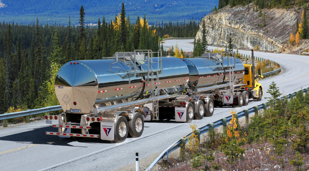

    In Canada there are many trucks spec'd the same as yours that are pulling 140,000lbs gross weight over 500 miles every day on the prairies in hoppers,flats and tanks.
    This is done on 2 trailers with 5 axles total.
    If hauling in mountain and hill country then the specs are increased to normally 525 hp or more, 18 spd trans, and 46000 rear ends usually 3.90 or more ratio
